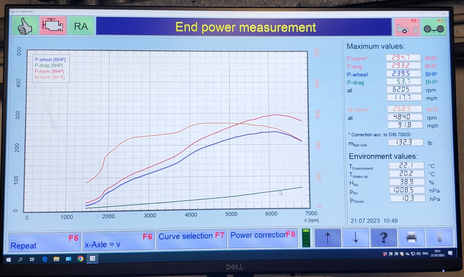

I was first up on the dyno when Richard & I went. The smell of rubber was strong till they applied WD40 & more strapping so run 1 showed 160bph from memory vs 280 plus on the second.
£45 is dirt cheap I think we paid £75.
It is cheap John, but you get what you pay for.
At SRR you're on and off in a blink of an eye so it's all over before you know it, that's where my EMU Black SD card based logging system comes in as I can review the run later millisecond by millisecond sat in the comfort of my sofa back home..
The SRR Saturday Morning Dyno Shootout business model is all about volume, they've been doing it for years so have perfected the whole thing into a finely choreographed exercise. It's fine for getting a quick number on the cheap, but frustrating for me as I'm used to spending at least an hour or two on the rollers tuning load sites.
As I expected, the one thing the log did tell me is my IATs were up to 20c higher on the rollers than they are out on the road in the real world, the data suggests I could have easily been down as much as 5% from air density alone, that would put me at a true figure of 181hp at just 6,500rpm. If we then say wheelspin is the cause of the dip from 6,500rpm to 7,250rpm where the Newman cam spec says peak power should be, then extrapolate the line following its natural trajectory path, we would end up with a true 'on the road' figure of 192hp.
That's just a couple of the many reasons why I tend take these rolling road sessions with a large pinch of salt nerd

Very true. We did get a lot of time on the rollers. I see dynos as you do. Idicative but not definitive for the reasons you state.
Here is Belle's second run.

Dave, I've followed your journey with some interest as I started something similar with my old 4/4. Firstly tuning the 1800 Silvertop Zetec and latterly transplanting a 2.0L Blacktop Zetec. (before I was seduced by the Roadster) Bear with the initial descriptive stuff because you may not have seen my older posts a few years back.
I used a basic Omex ECU which didn't have much in the way of real time data-logging so I did most of my development work on a friendly local dyno.
While I was playing with the 1800, I went through a few stages. Firstly I ripped out the original ECU and wiring and put in the Omex together with removing the Morgan intake and MAF meter but retaining the standard Ford plastic inlet manifold and throttle body. Aluminium on the old silvertop if I recall.
I also fitted the Librands manifold and exhaust system but retained the standard (400 cell ?) cat.
Can't remember the numbers but I do remember being very pleased with the initial dyno set up and runs which prompted me to carry on the tuning so I had some very mild head work done (standard valves) and fitted a fast road cam (Kent).
Went back to the dyno and played about with the mixture and ignition mapping and was hugely disappointed. Very little gain in horsepower and a horribly lumpy torque curve.
Dyno mans first thought was let's alter the cam timing a bit because the standard settings for the new cams might need tweaking to suit this set up. However, I had not fitted vernier cam pulleys so we couldn't play any more.
So abort that session and go home to fit some vernier cam timing pulleys and then back a few days later to play with the cam timing
We played about by advancing and retarding the cam timings and in the end we did get better results both in peak horsepower and a smoother torque curve but still nowhere near what I expected.
He felt that the problem was that the cams were trying to produce peak hp at 7000 rpm but the manifold was tuned for the standard cams at about 6000 IIRC and so they were in effect fighting each other.
I didn't want to start playing with throttle bodies and in any case I had a brand new 2.0L crate engine sitting in the garage so I stopped the 1800 work and dropped the 2.0L in using the standard inlet manifold and throttle body and the same Librands exhaust and Omex set up from the 1800.
After running the engine in for a few miles I went back to the dyno, tweaked the fuel and ignition mapping and we got 160hp @ 5920 and 157lbsft @ 4420 rpm. But as I said earlier I was then seduced by the Roadster
Anyway, when I saw your dyno run it brought a few thoughts to mind.
I don't think you are getting wheel spin at 6500 rpm because that's well past where peak torque is occurring and assuming this was a 4th gear dyno run the transmitted torque to the rollers shouldn't over power the traction with the 2.0 litre engine unless the drum was very slippery. (Usual caveat. I could be totally wrong)
When you are happy with the fuel and ignition mapping, I would be tempted to look at the cam timing and adjust it a bit to see if you have got the Newman cam optimised for your engine set up. A few degrees advance or retard could make a significant difference.
It might also be worth considering if the length of your intake runners are in tune with the cam profile. IIRC you have fairly long runners on the inlet which should give good low down torque but are the pulse timings matching the camshaft inlet timings. Just a thought.
