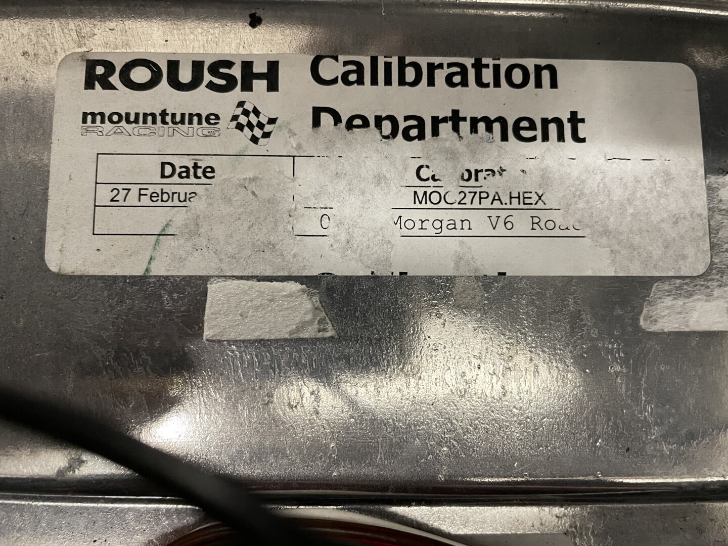

Mountune also developed ECU calibrations on some of the Roadsters for Morgan / Powertorque
This is the sticker on my Roadster ECU
[/quote]
Interesting Bob, I never knew that, much like Cosworth, Mountune seem to be engine and engine management tuning consultants to OEMs like Morgan (via Powertorque), Ford, and others. My attempt to copy the Mountune MR200 kit has certainly given me a super smooth driving and torque rich engine with an additional 30hp over a standard Plus 4, throttle response is also massively improved.

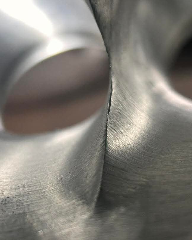

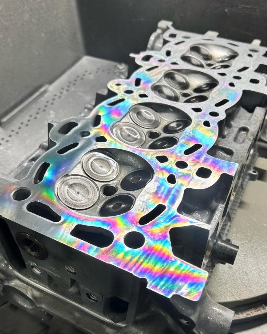

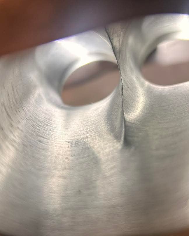

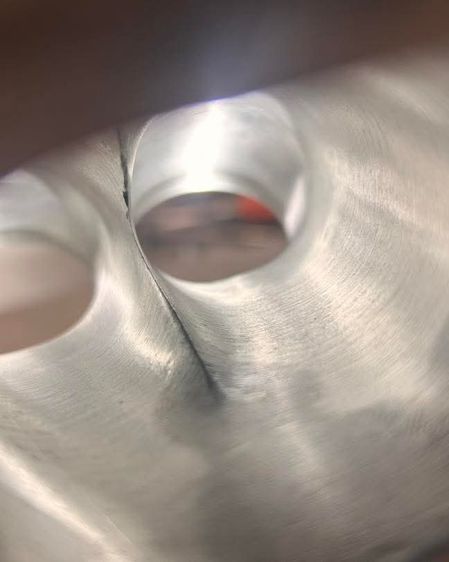

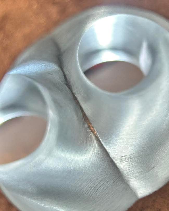

So in addition to a few rear suspension experiments discussed on the other thread, my latest hairbrain horsepower improving scheme includes this fully ported cylinder head from AL Develolments who are the masters at porting the Duratec.
Monty also goes from his current Newman Phase 2 cams, to a set of Newman Phase 3's.
After fitting the head and carefully dialing in the cams with a DTI to avoid any 'valves meet pistons' mishaps, I should have concluded my mapping work and put Monty back on the same dyno at Surrey Rolling Road by mid March. Even after some ignition timing changes Monty refused to give more than 180hp, but he does have an amazingly broad spread of torque while still delivering outstanding everyday drivability.
I should probably stop tuning but as we know 'power is all corrupting' and I remain determined to make over 200hp, this while stubonly avoiding going down the ITB route. Fitting ITBs may come eventually, and with them Monty would easily hit 235hp plus with the new head and cams. However, I absolutely love my Fusion Fabrications long runner inlet and the mid range punch it gives.
The new target is really just another crack at my old target of 210hp while retaining Monty's pussycat town manners, I'll add an update here when the results are in.
