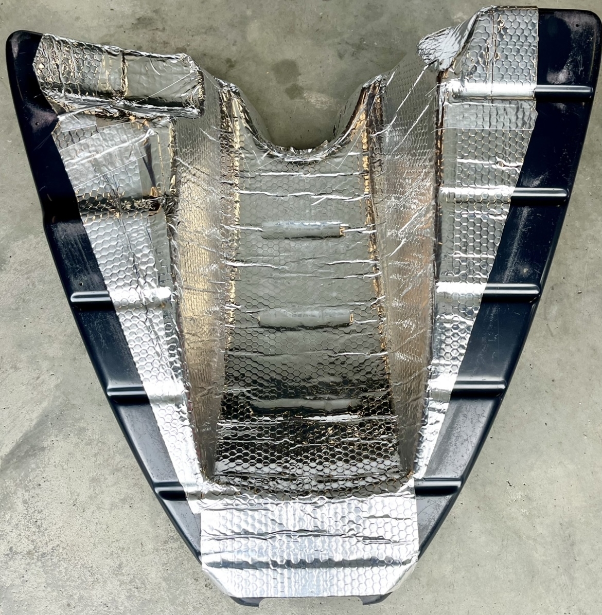

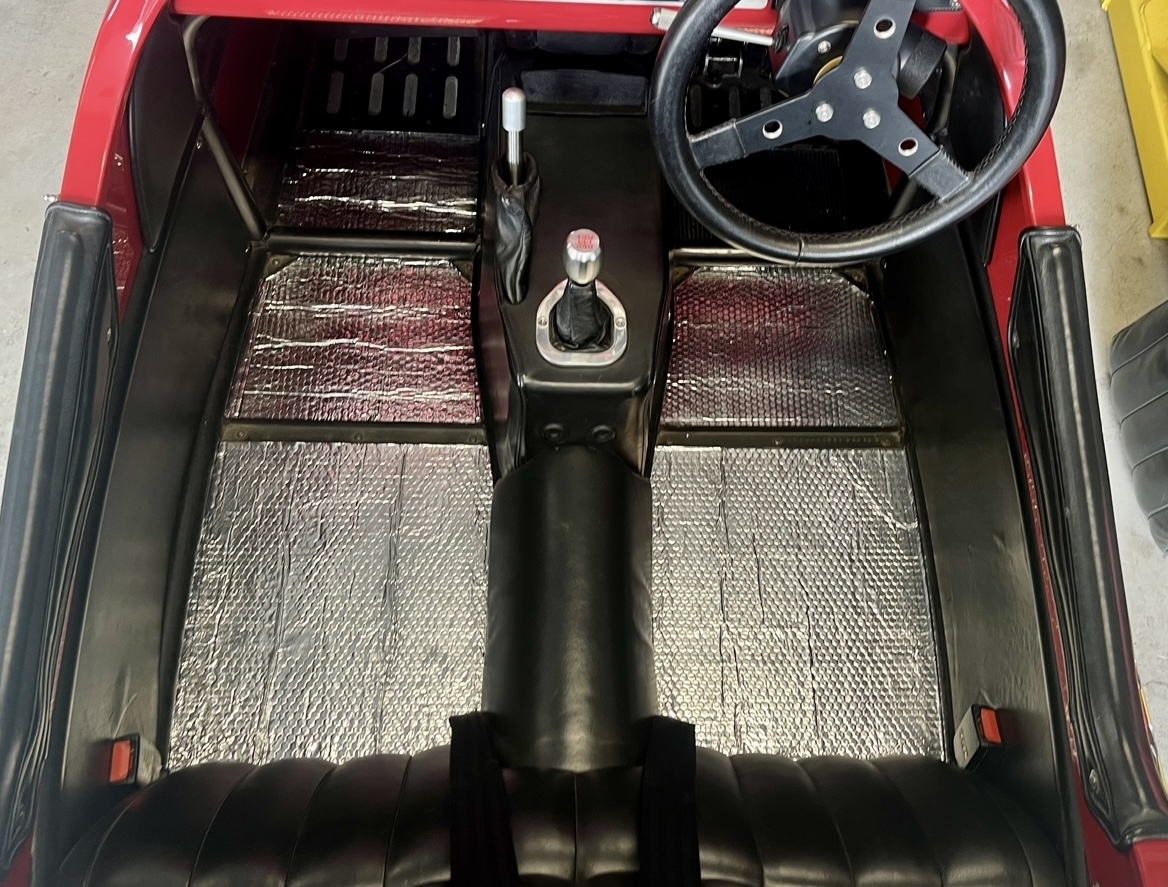

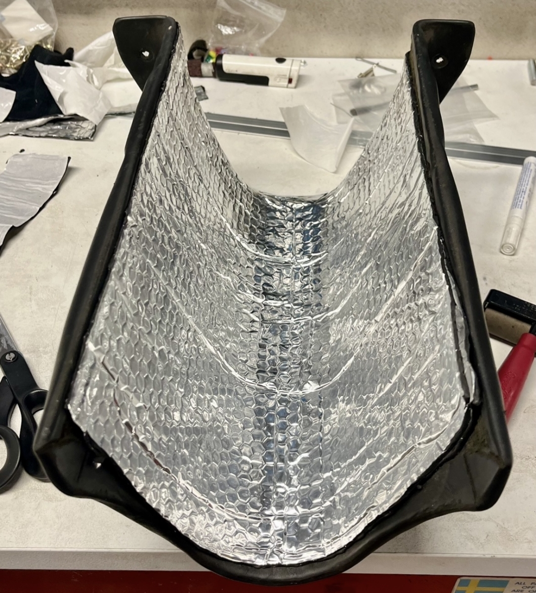

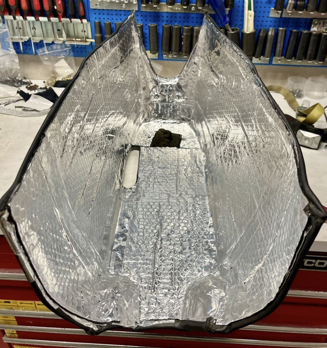

Might be worth mentioning a few words about how sound reaches our ears in vehicles.... The Airborne sounds (mainly wind & exhaust) are effectively filtered using earplugs or wearing a helmet- I personally enjoy these are therefore don't filter them. The Structureborne sounds (mainly gear whine & click/clunk) can quite effectively be damped by using the material shown above. I don't really enjoy these noises, so I choose to filter them. I would describe the change more as an increase in "solidity" rather than a decrease in overall volume. It tends to leave the desirable Airborne exhaust & wind sound a bit more "pure". In the M3W specifically, insulating the two flimsy plastic tunnel covers (small one over the driveshaft & large one over the transmission) give a significant reduction in the Structureborne gear whine from the bevel box and click/clunk from the driveline backlash.

Dinko, the M3W has aluminum, not wood floorboards, so the rotting plywood scenario isn't relevant.

Leopold - I have done the same with my 2015 M3W and noticed a positive difference in the sound. I've also noticed a difference in the heat coming through, i.e. slightly less. Also happy to see less dirty / dust coming into the vehicle through open seams - which is a nice bonus.
However, I still get annoying metallic rattles at certain speeds / rpm. It's as though, when I hit a certain rpm range, the normal vibrations create some sort of harmonic effect. To me, it sounds like two pieces of metal (like aluminum) rattling together. Not a deeper, steel sound. So, I regularly go around the vehicle with Allen wrench / hex key, screwdriver and nut driver and make sure everything I can reach is tightened down. The only place I can think of that could still be making this sound is the floor, so I'm going to tighten those up this week too.
Any similar experiences or solutions on your end?
