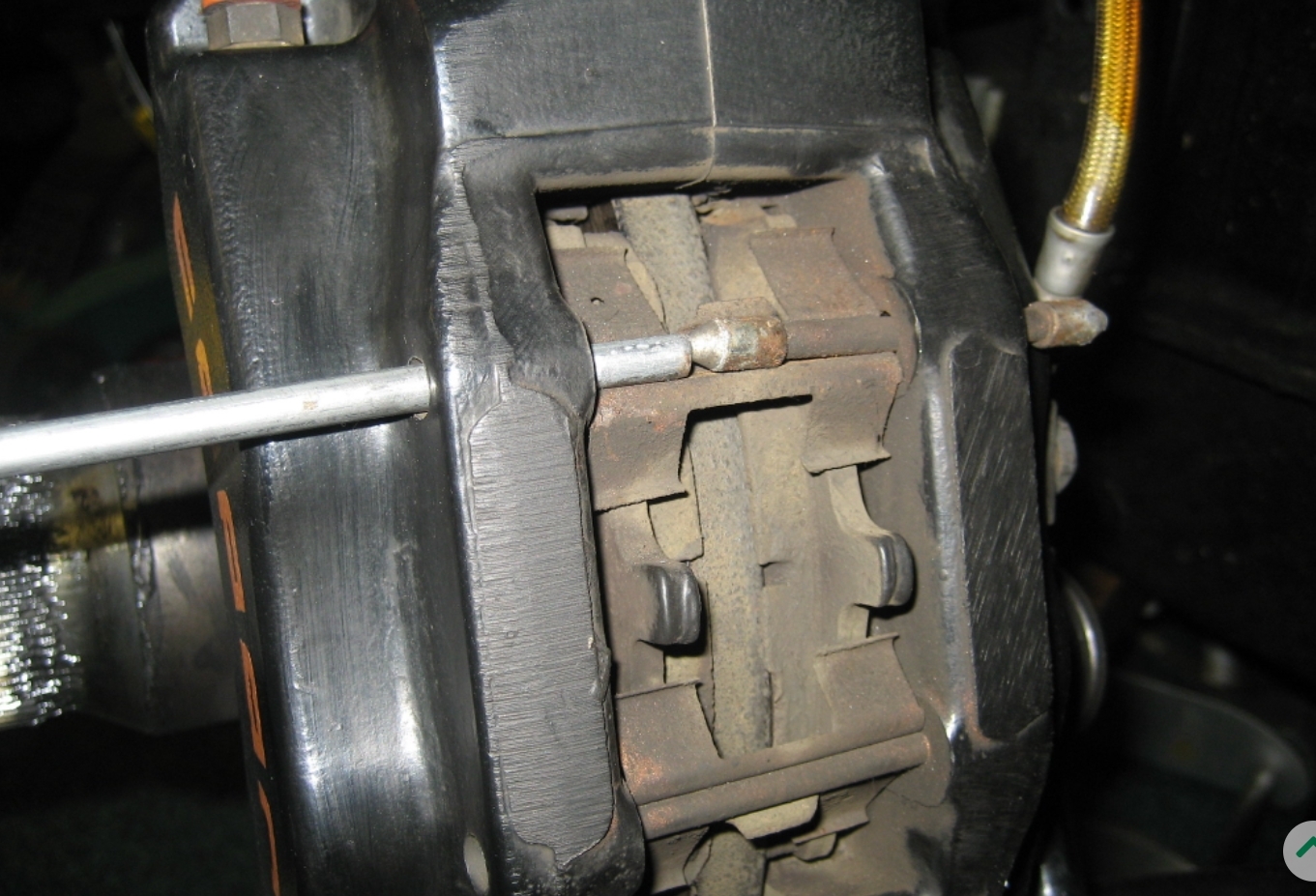

Don't forget about the lip of unworn pad material you sometimes get on the outside edge of the pad!
Just visible here...............
