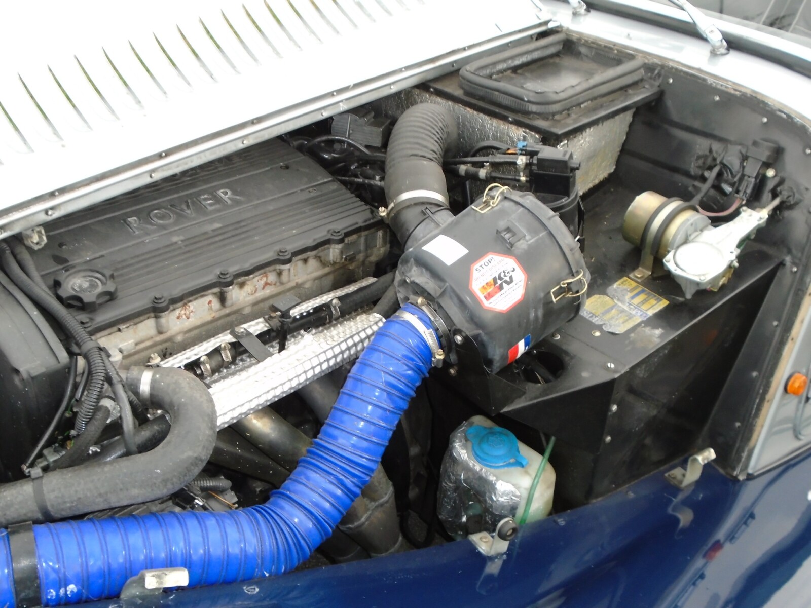

I had a 1993 4/4 with Ford 1.6 efi engine.
It came with a steel heatshield bolted onto the exhaust manifold. The air intake was a plastc/flexi pipe about 100mm(ish) that went above it so the intention was to protect that from high manifold heat. I had to replace the air intake pipe as it was deteriorating due to the heat in the area where it passed over the manifold that the shield was letting past.The replacement was a similar material but I wrapped it in reflective heat shield material. A simple job that worked. You could also stick some heat insulation to the bonnet. BUT....removal in a safe way of hot air so it doesn't affect components should be a priority, as is shielding components.

I fitted a heat shield over my Librands exhaust on my T16. I also replaced the air inlet pipe with heat resistant tubing as the original was burnt through underneath. I also put heat insulation on the wash bottle.
