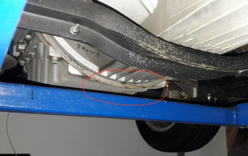

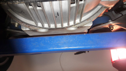

I'm not brave enough to modify the crossmember as Montegue did
But I did grind off the steel flange protruding below the bellhousing - from this
to this
