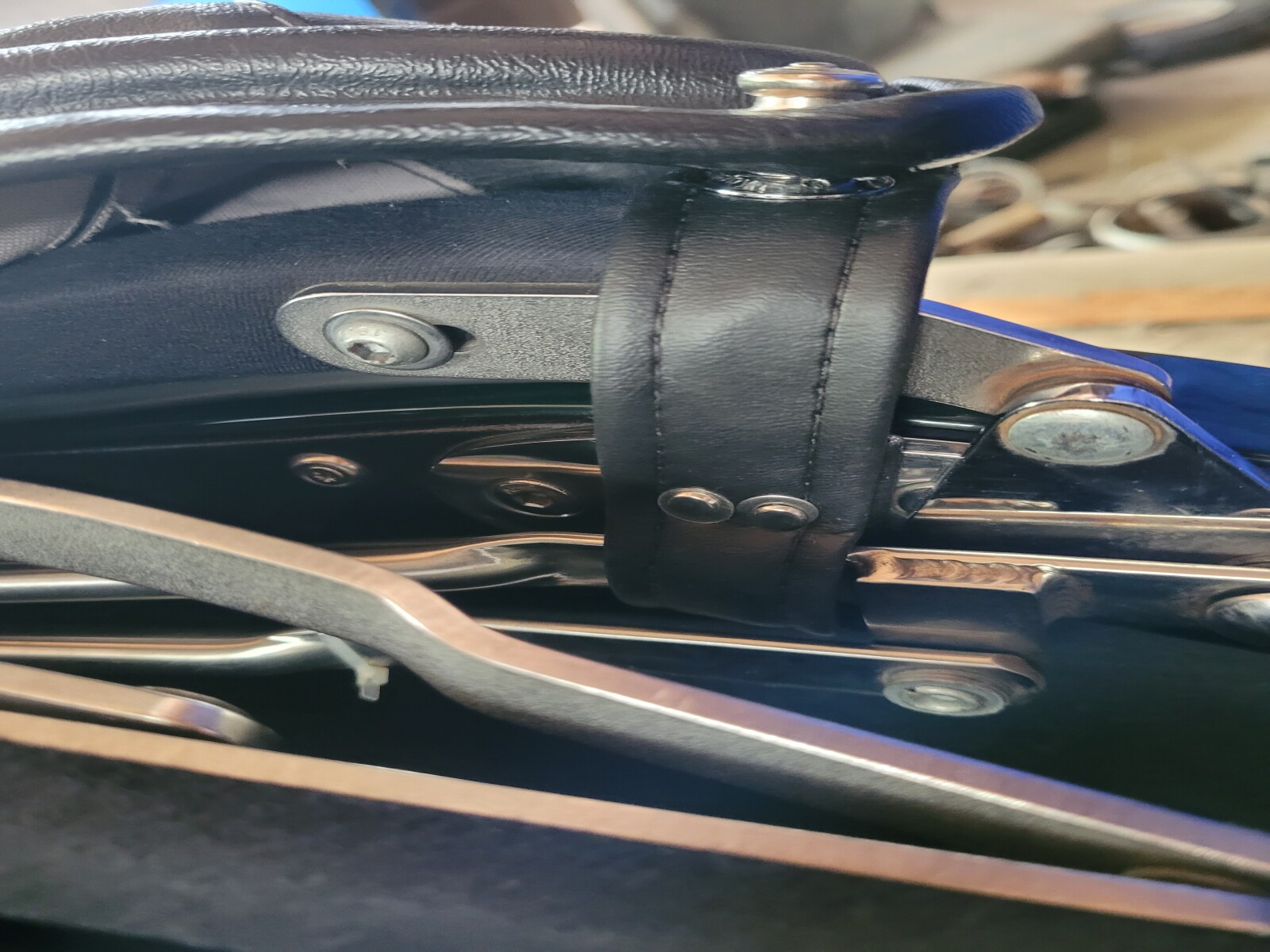

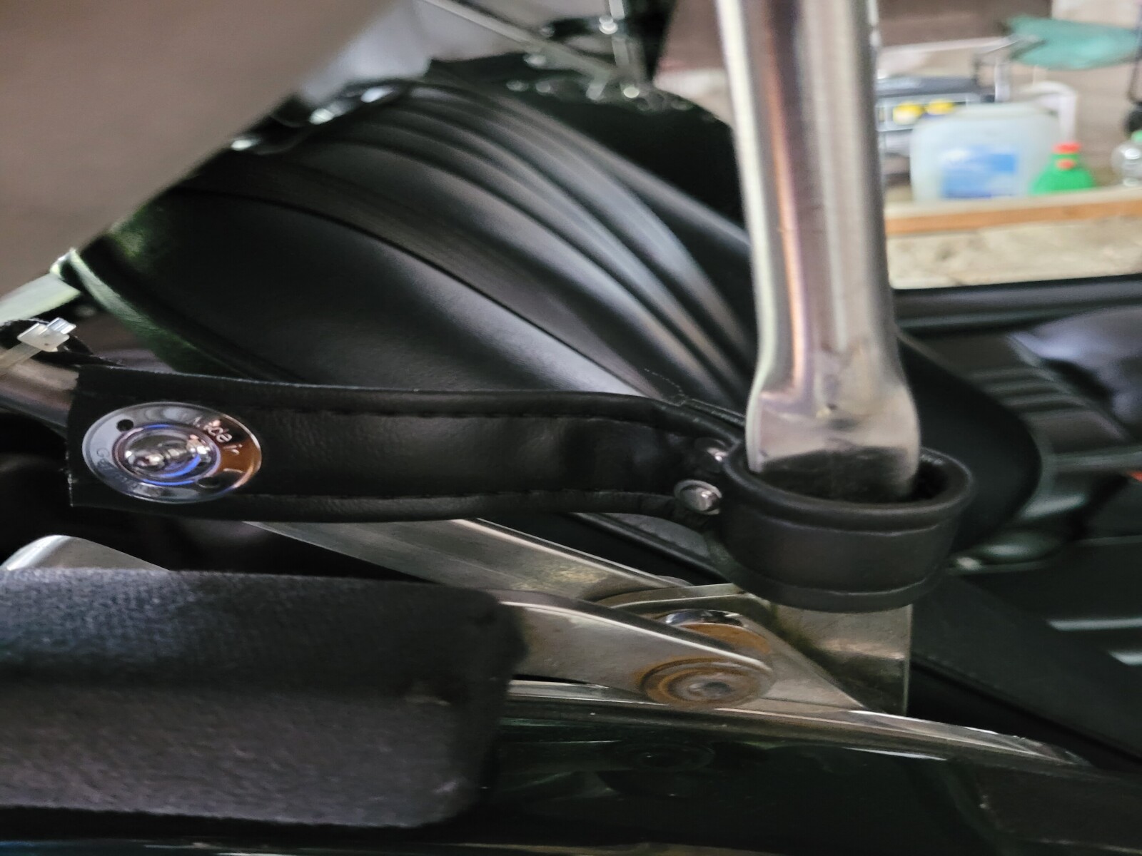

My wife was bothered by the fact that, on our 4/4 , the ends of the soft top flutter whenever we drive with the soft top down (i.e. all the time).
Following a tip here on TM, I screwed Tenax fastener in place to secure the front sections of the hood to the two wooden slats of the hood frame:
- First time, I did it on the wrong side of the strip.
- The second time, I measured the distance very precisely to the fastening straps of the soft top on the frame.
Of course, only on one side. And of course, Morgan chose completely different distances on the other side.
So there were even more holes in the covering of the wooden strips.
What’s more, the corners of the soft top were now lashed very tightly to the frame.
As the hood shows some small cuts in recent years (at the edges), I took it down and had these areas reinforced by the upholsterer.
Whilst he was at it, he reupholstered both wooden slats with fabric.
By doubling up the these repaired areas, the edges no longer flapped about!
However, my wife thought it looked rather unsightly when the corners of the soft top were sticking up…
As I sell motorbike parts, I had some retaining straps from my CX500 seat covers in stock:
- I cut two short straps to size.
- Attached the straps to the frame using Chicago screws.
- Attached one Tenax fastener to each strap as a counterpart for the hoods Tenax fastener.
Result!
