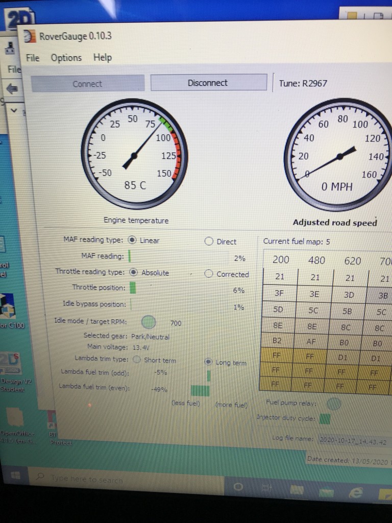

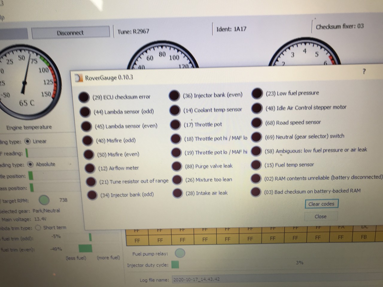

Ran the obd scanner today, no fault codes and this..
Engine idling in the garage and up to temp - fan kicking in.
Thoughts?

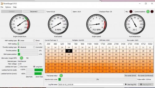

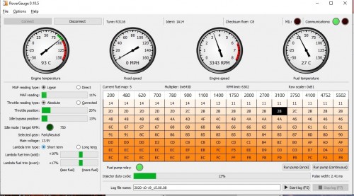

Rovergauge screens from my +8 as follows, the fuel map is very slightly different to standard
first is fast idle at a bit over 3,000 rpm
second is idle at 750
Main difference is that the MAF reading goes up from 3% to 11%, throttle from 6% to 20%, injector duty from 3% to 13% between idle and fast idle
