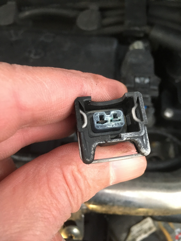

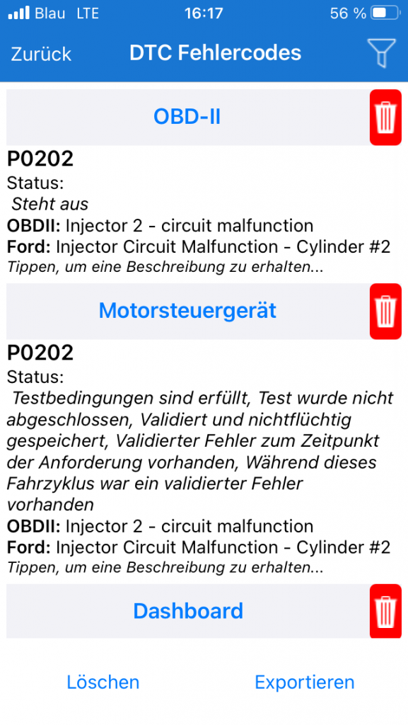

Today I had a little tour with the 4/4 in the best weather. In between, I went for a walk in the countryside. When I came back and wanted to start it, only three cylinders were running. Luckily I have my OBD2 with me. It showed error code 202, indicating that one of the injectors was not getting any control current. It was injector no. 3. Luckily I had some electrical contact spray on board. Funnily enough, after spraying, injector no. 2 was without power. I pulled off all the in injectors in turn. In fact, the OBD2 was able to identify each injector by number.
I cleaned all the contacts of all the injectors. I had to wait about 30 minutes until all injector contacts were dry and working again because I had no compressed air on the road. And blowing was not strong enough. Before this 30 minutes and after spraying in front of time she runned on one cylinder only.

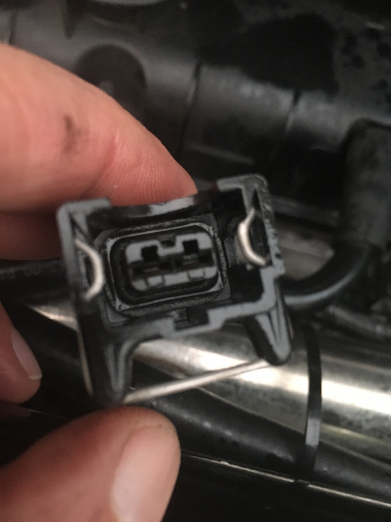

In the end, the car was running properly on all four cylinders again. The pictures show how much the contacts had oxidised after six years and 92,000 km.

One of the plugs before cleaning when running on three pots only...underway.
and the corresponding oxidised counterpart of the plug.

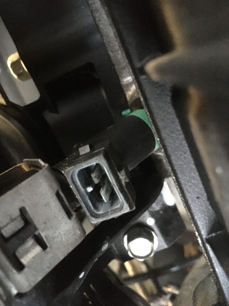

after spaying the plug and the counterpart...and waiting.
Why I am sharing this...it is always good to have an OBD2 on board before you have hundreds of other suspicions. It helps to narrow down the fault significantly.
