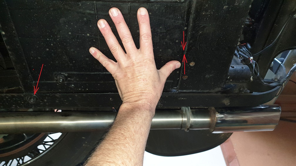

I don’t know if it’s just a feature on my car but the fuel tank is not secured. The wooden decking that the fuel tank is bolted to appears only to be fixed by two bolts towards the front of the decking. The rear of the decking just sits on the chassis under gravity. If you push as per the pic you can lift the decking and tank. It can produce a clunk like the jack is loose in my wooden tool tray. I must get around to securing it....
