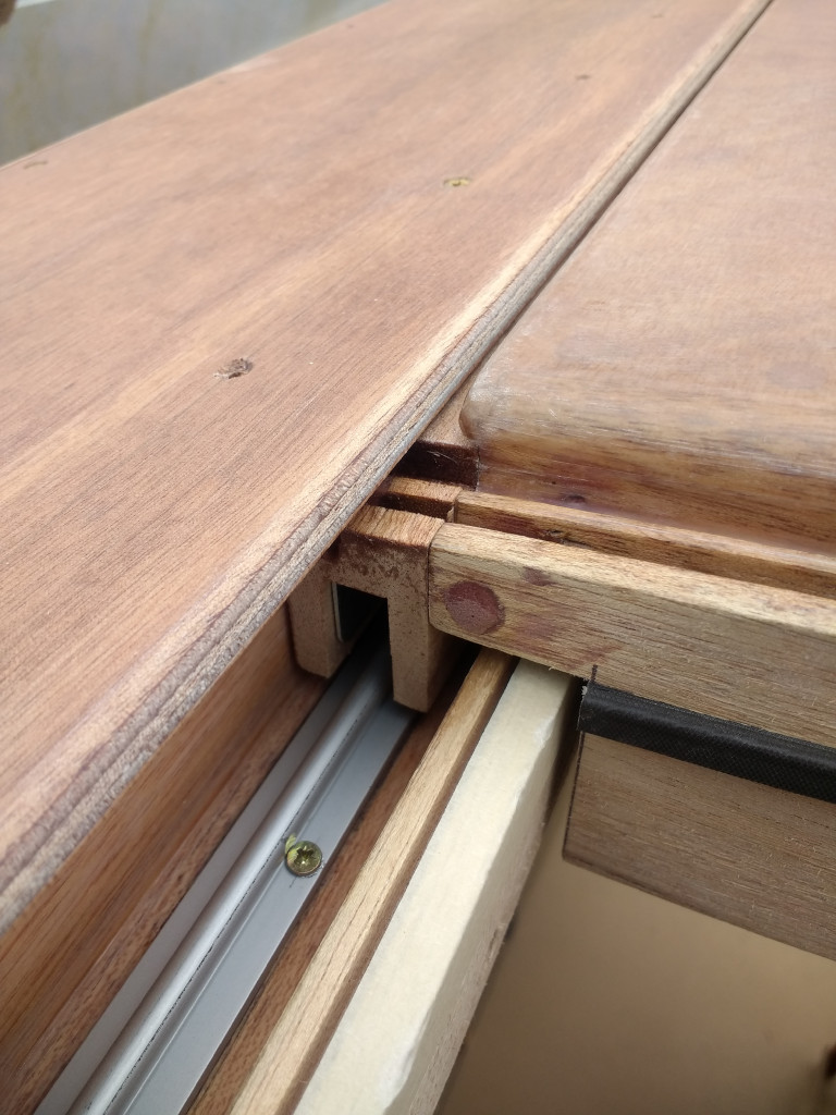

Back to the dreaded fibreglass and rubbing down! I wanted a big opening roof and considered glass, too expensive, Webasto canvas type, security issues, so worked out a design using two patio door tracks and two pairs of adjustable rollers. Where the sander sits is the well for the roof to slide back into. You can also see the drainage pipe to allow rainwater to escape from the track channel. Three either side.
A close up of how it works, prior to all the weather seals being fitted in the grooves.

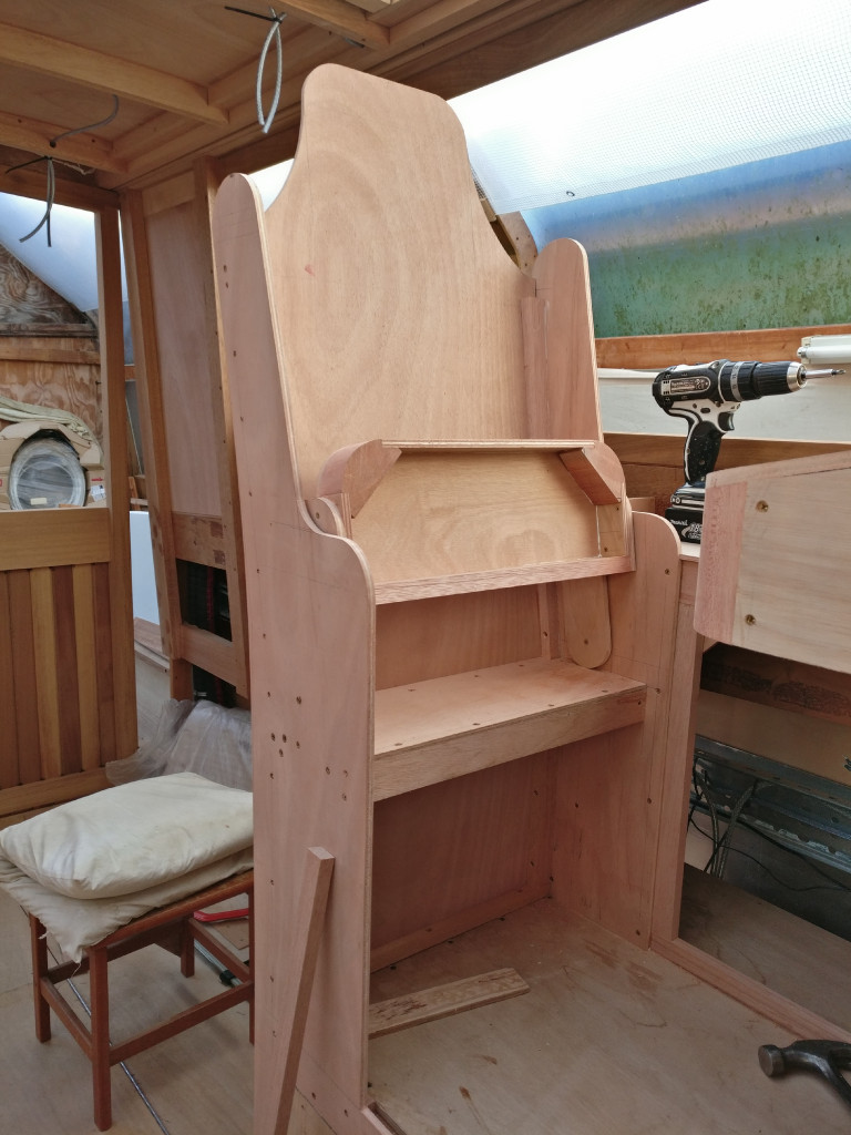

The helm seat flipped up. Required when standing.
And the below helm seat locker lid that acts as a step up for people like me with ducks disease.

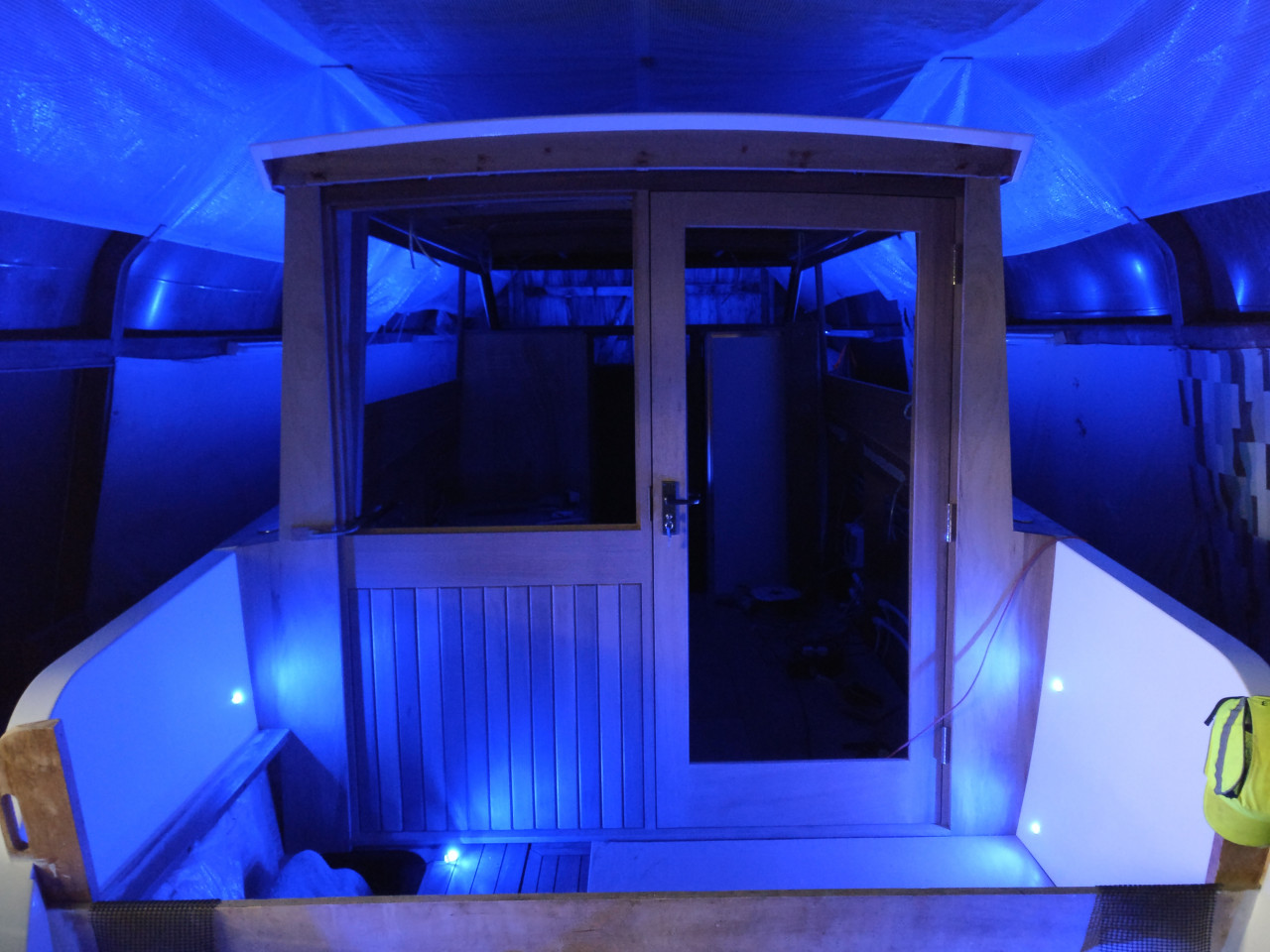

Cabin entrance with the outdoor lighting. The LED lying on the deck will be fitted into the water pump locker when it's fitted.

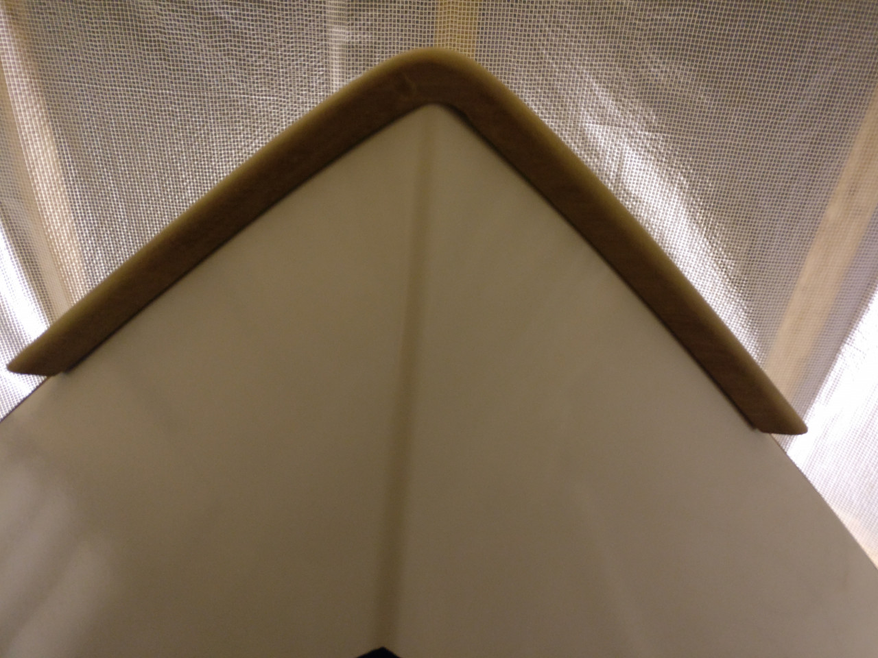

The Iroko bow piece from below.
And above, took the best part of a day to carve and router this part, a CNC router could probably do it in 15 minutes after programming.

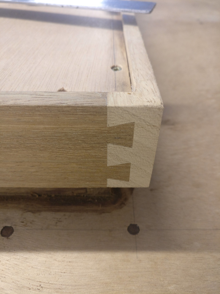

The rope locker hatch, ready for teak planking. I'm not a total luddite, I'm selective like George πŸ˜„ the dovetails are done with a jig and router. Completed in a fraction of the time that it used to take me and same end result.
