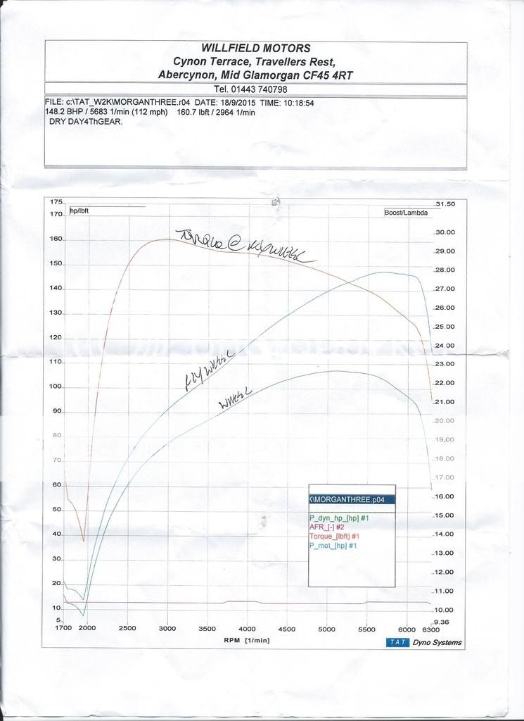

Not wanting this to drift into next year I have paid for specialist tuning and a dyno test myself , conducted by Matts Machine Shop , result below.

The main upshot of the dyno run was to prove there were no underlying faults , and to point the way forward for further improvements.
The tuning experts reported 'no faults' , and the guys who knew what they were doing were pleased with the relatively flat output over the rev range.
The dyno itself was capable of measuring BHP through the drivetrain, so it could give results at the engine flywheel and at the rear wheel. This let Matt ( who is a very experienced S&S tuner ) give comment on his area of expertise - the motor itself. Even with the Morgan stage 2 exhausts he believes more free flowing exhausts , ideally without the cats ( not a viable proposition to keep it road legal !! ) would be a simple and useful direction to take it for more power.
The 148 BHP at the flywheel / 110 at the wheel is about what they expected , the difference being losses in the drive train , which is the norm of about 20%. The useful rev range of 3 to 5K containing the highest power at the wheel is good to know.
I dont profess to be a tuning expert , but the way forward for me for more power is to reduce drive train friction and investigate alternative exhausts.
