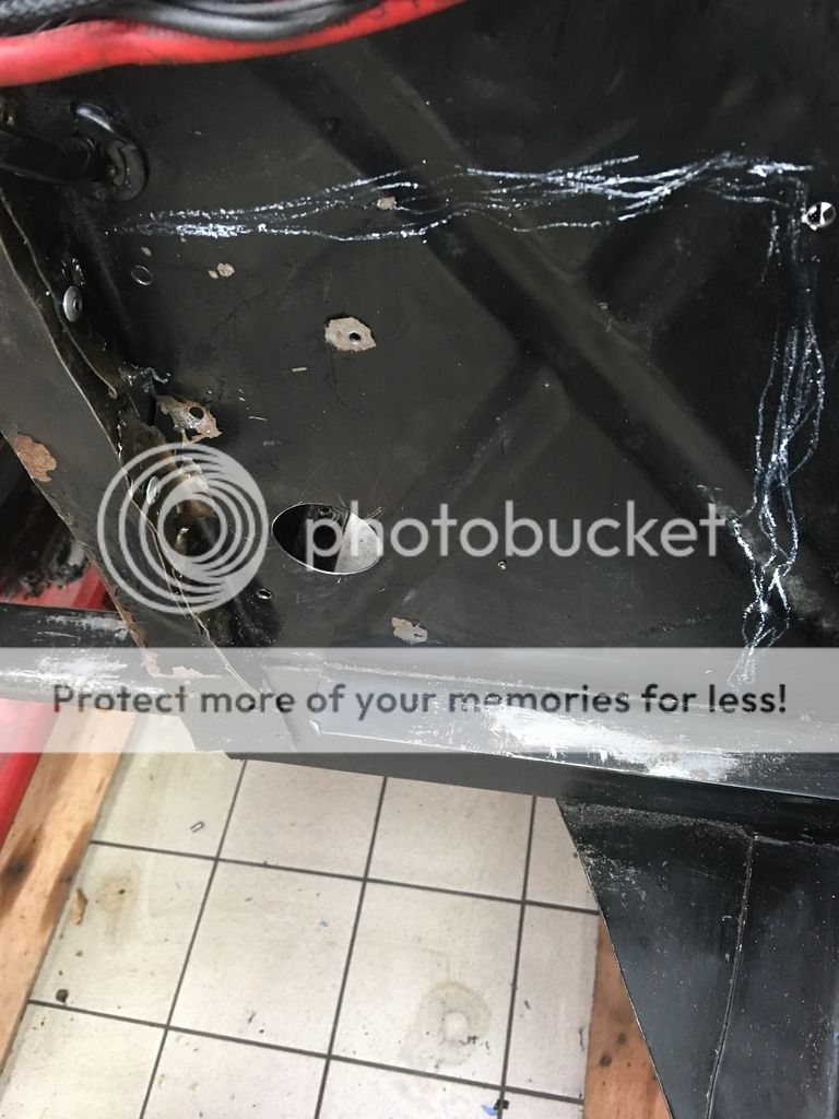

As the new engine is dry sumped, I now no longer need the old horrible looking oil catch tank which was poorly attached to the N/S bulkhead. The new oil tank comes with a breather tank attached.
I then made a carboard template for the 3mm sheet metal im going to use to over lay this part of bulk for strength. This is where the oil lines and fuel lines will come through using the correct bulk head connections. The original bulk head metal work will be neatened up and filled before the new sheet goes over the top.
Doesn't it look glamerous lol
