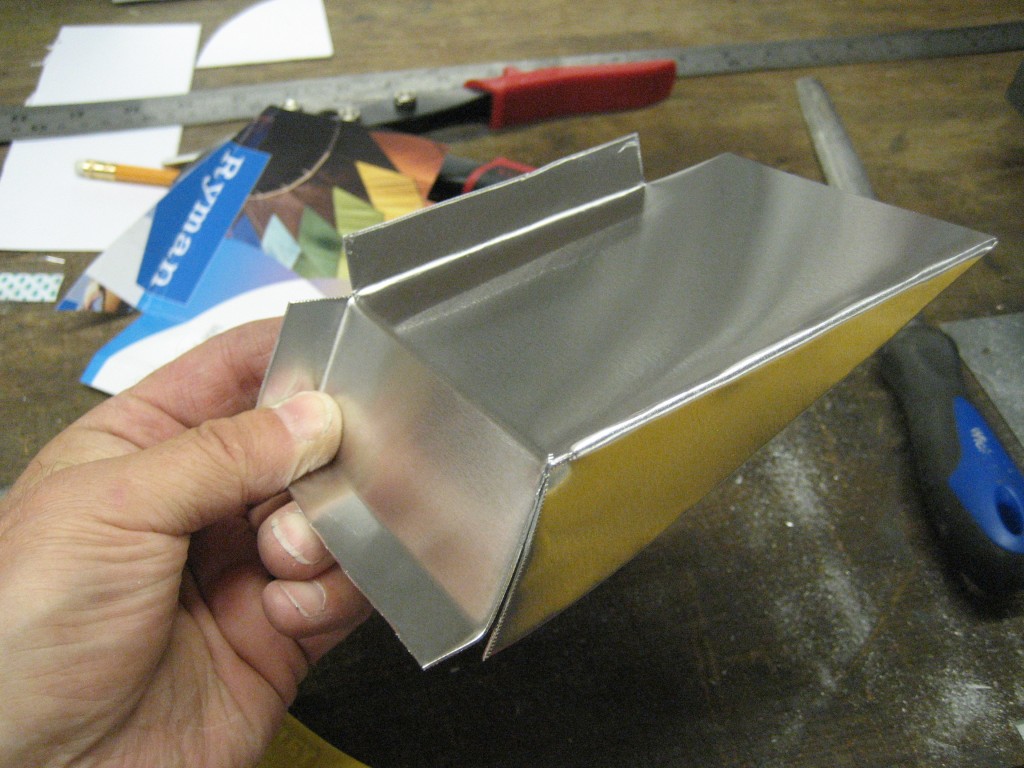

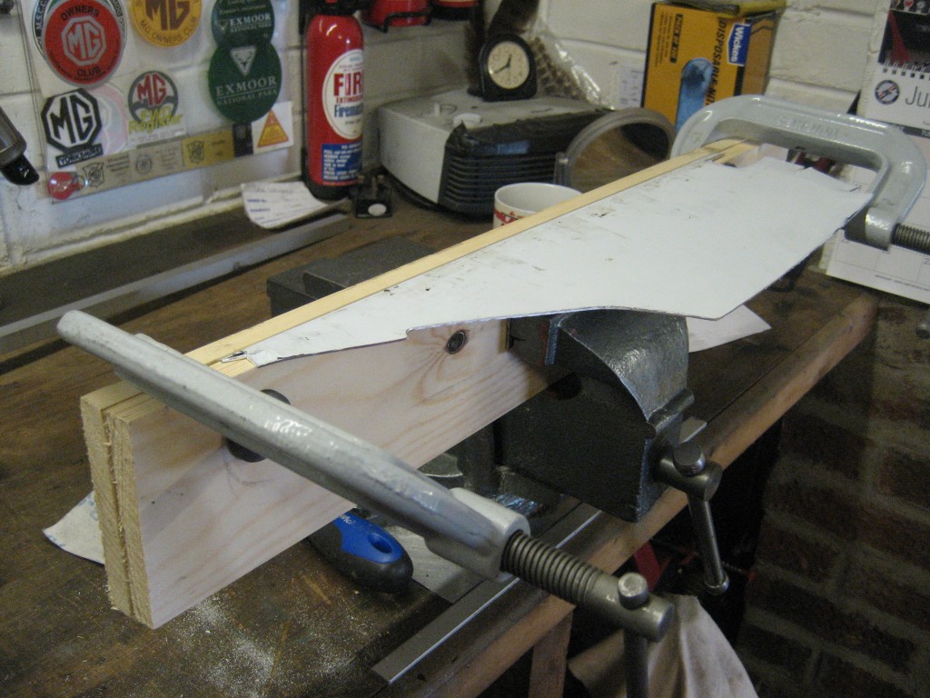

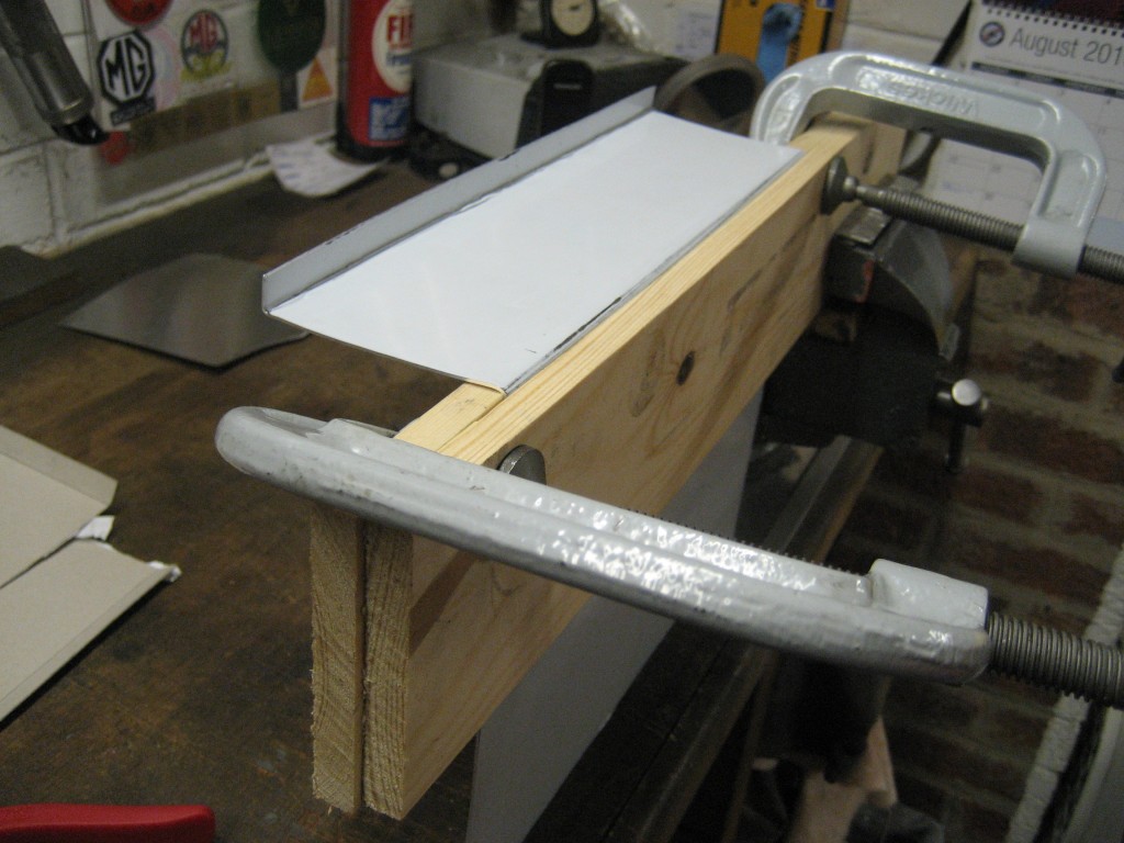

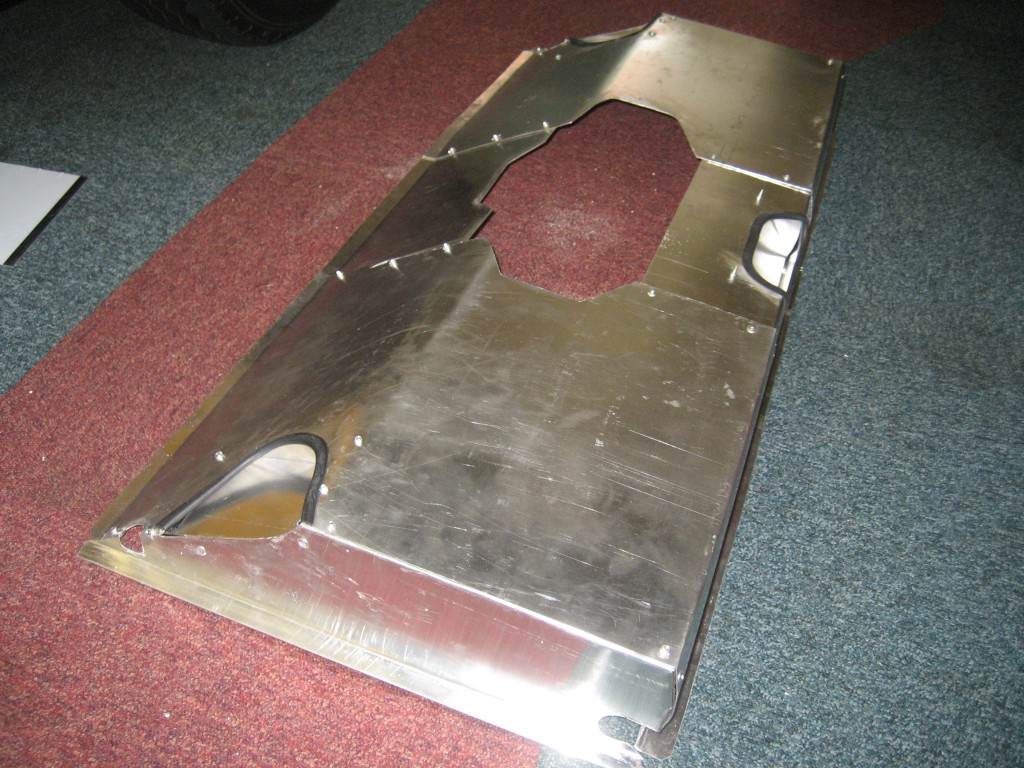

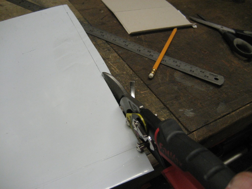

So anyway! - next I made some sides, first cardboard and then aluminium.

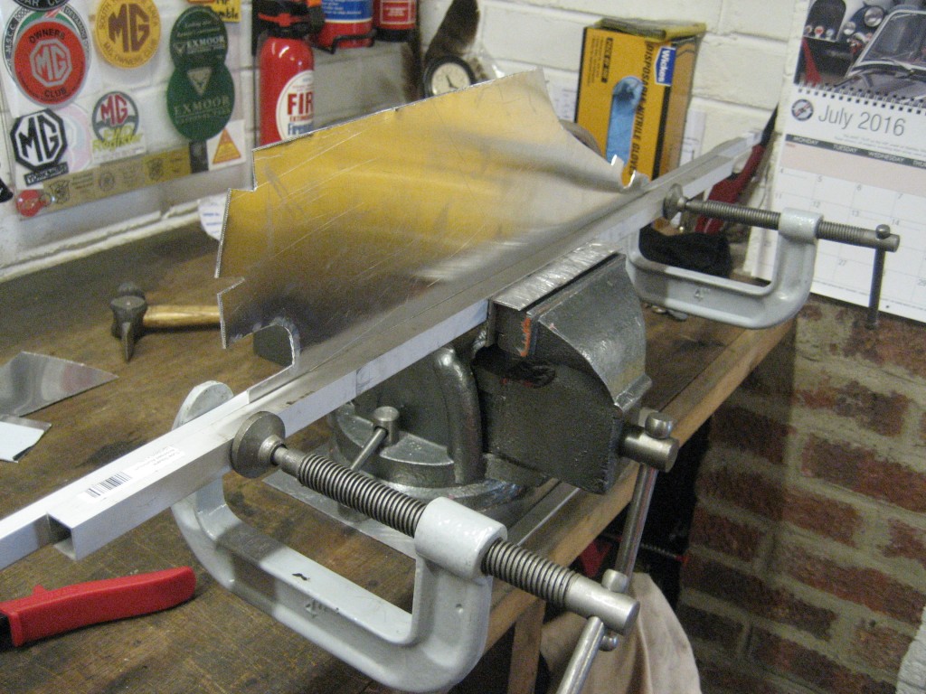

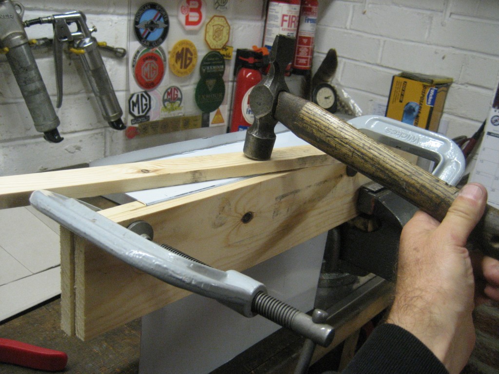

This is how I bent the flanges:

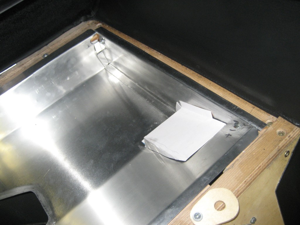

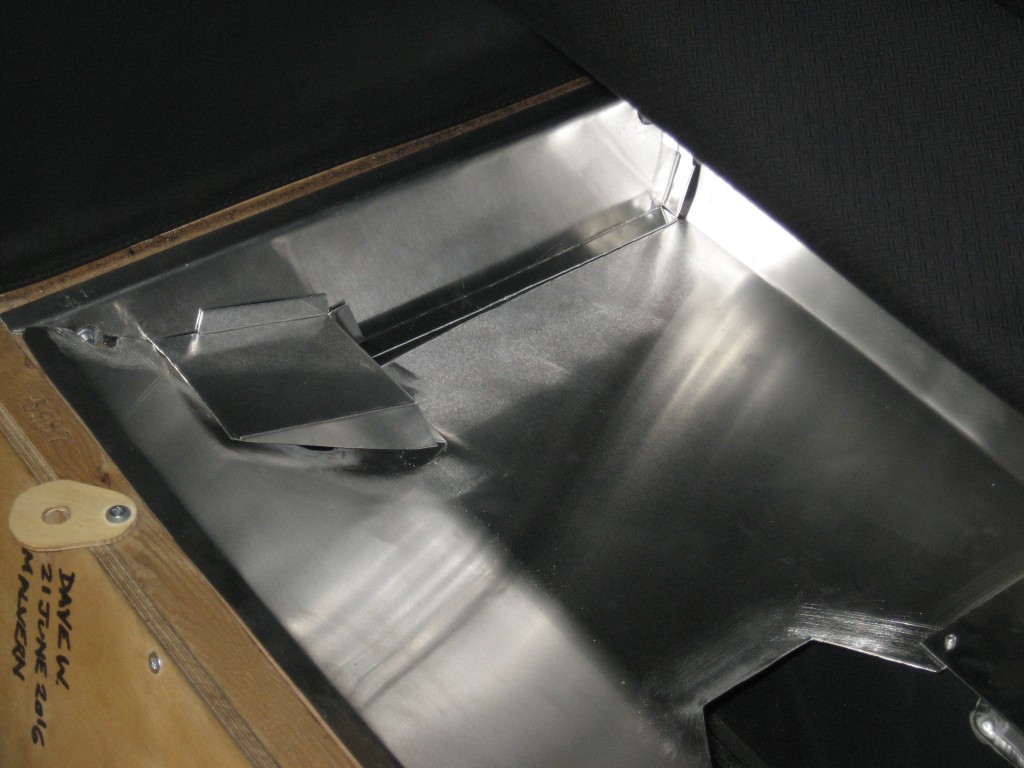

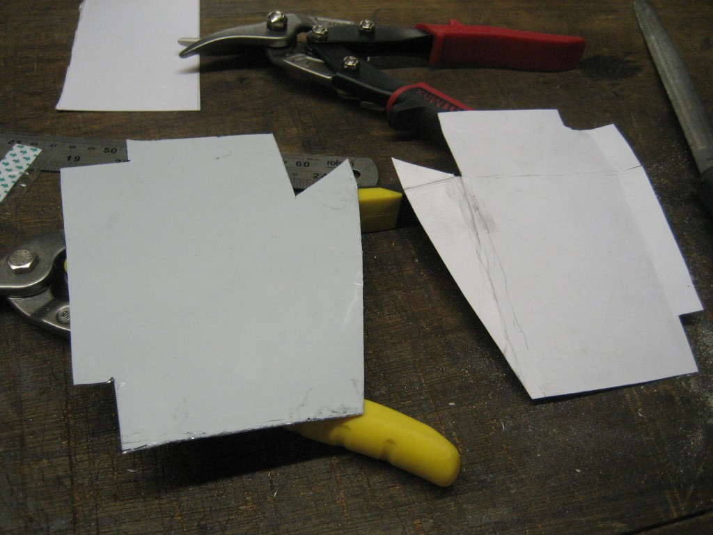

Then the damper mounting cover - here's the template:
Aluminium first cut:

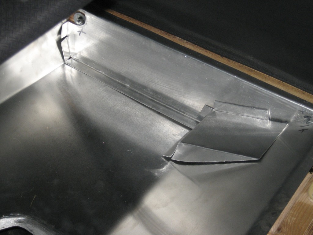

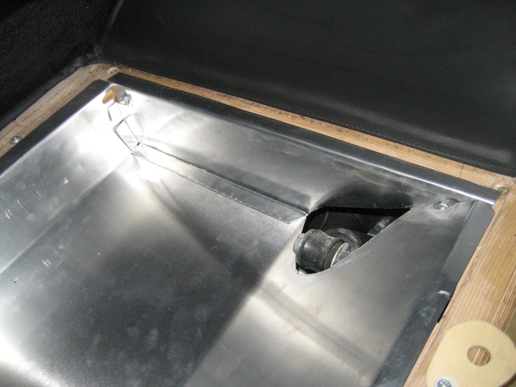

Completed cover ready for fitting/fettling.
Coming on well - I've used pop rivets this time.
I got hold of three tin snips for this job - straight and curve left and right.
Adding a tight bend:
More to follow....................
