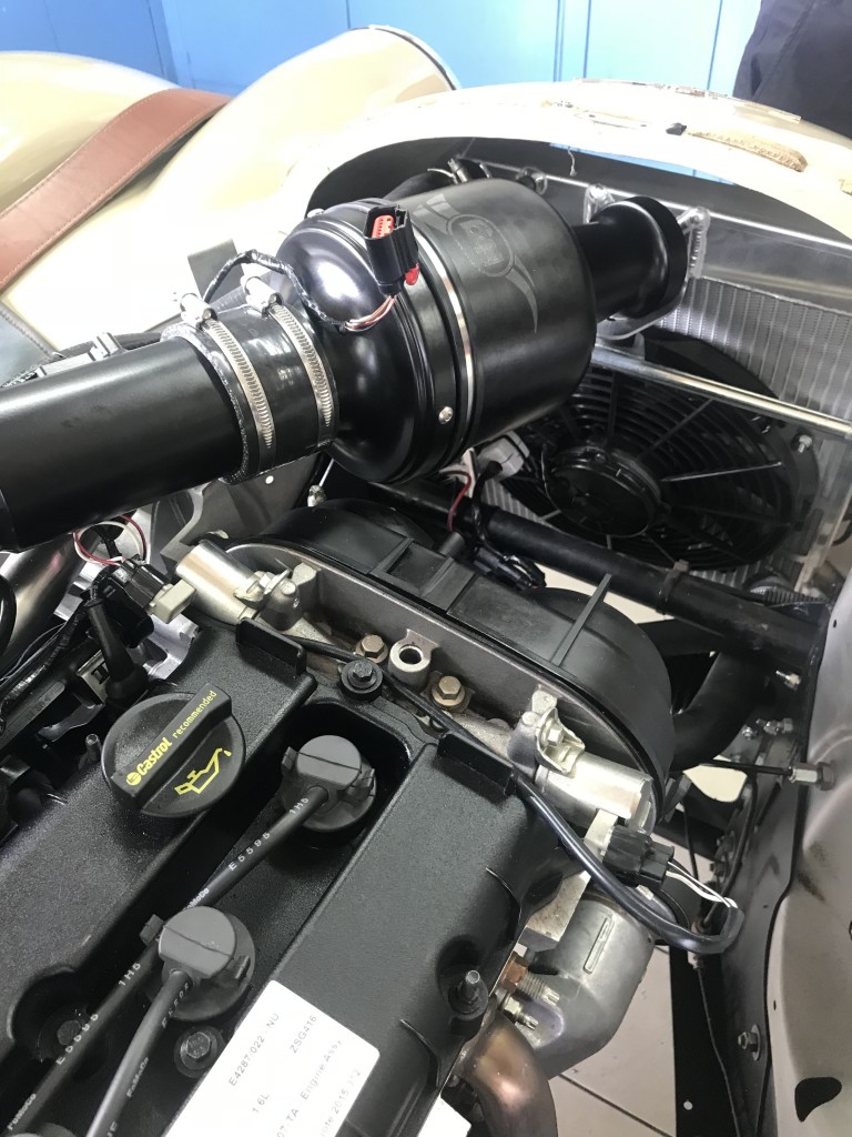

Can you perhaps take another photo of where the ITG 'box' is in relation to the top of the radiator as well? Cheers.
Pete, a few pics of the intake as requested. The gap I I have above the SiFab radiator is approx 60mm. The SiFab radiator is 520mm in length, whereas the factory radiator is 460mm in length. The extra length in the new radiator is mostly taken up in the bottom area. (hence 1 good reason I had the valance for radiator protection)
I do agree with the heat from the radiator being transferred to the flexi hose, but I’m reluctant relocate it if I have a noticeable improvement from the old air box, even with the K&N filter.
