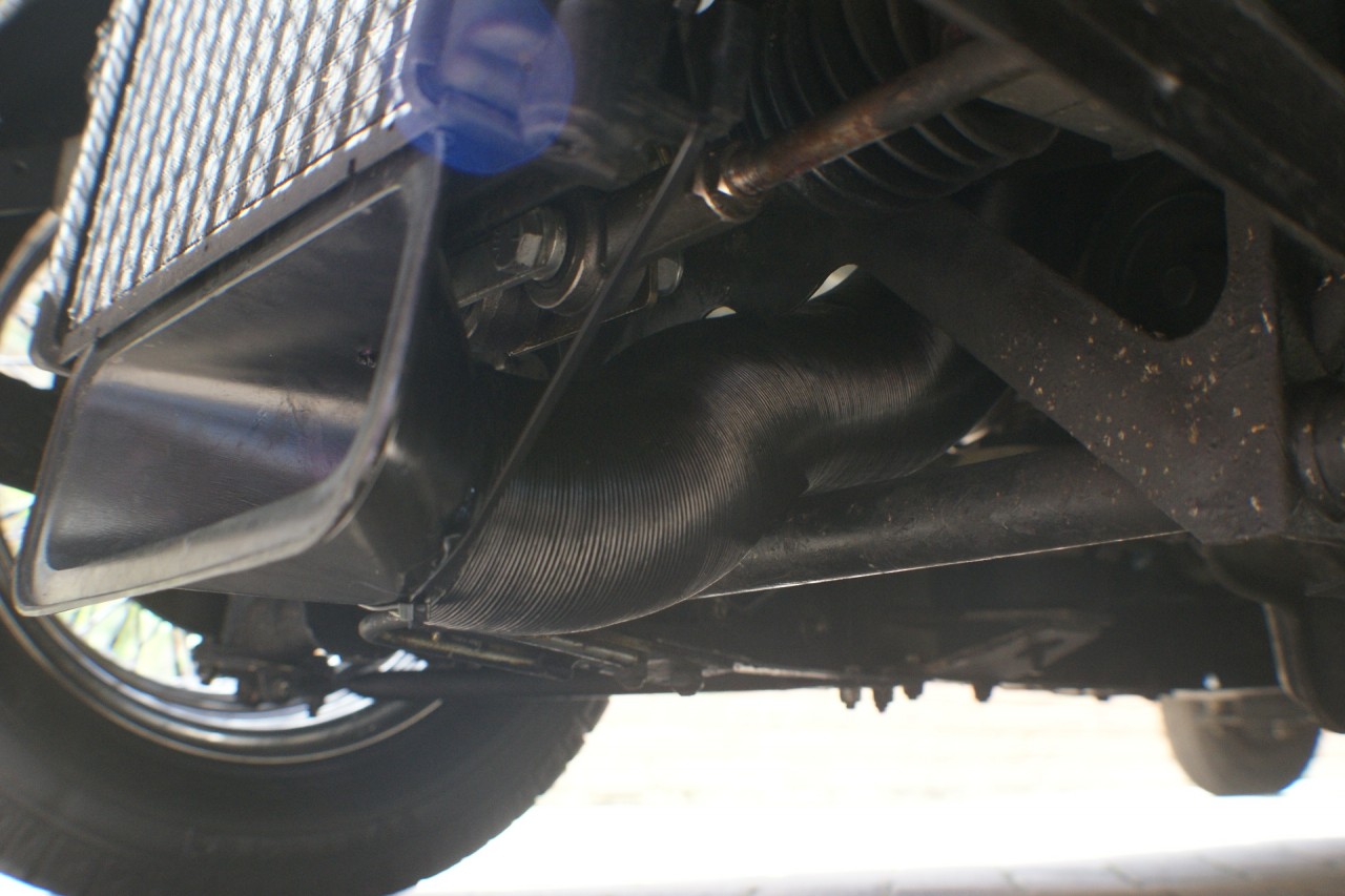

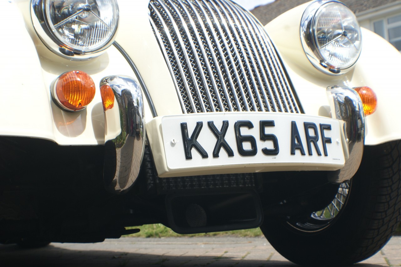

Regarding cold air being scooped up from under the car ( original air box) I have modified mine to obtain a "ram-air" effect. Works really well.
The scoop is in direct line to the flow under the car and seems to work really well. I have since added a mesh grill to keep leaves etc from being sucked in.
A flexi pipe then ducts upto the original air box ( with K and N) filter installed. Air scoop was under £20 and the pipe was £7.99 so a really cost effective job.
