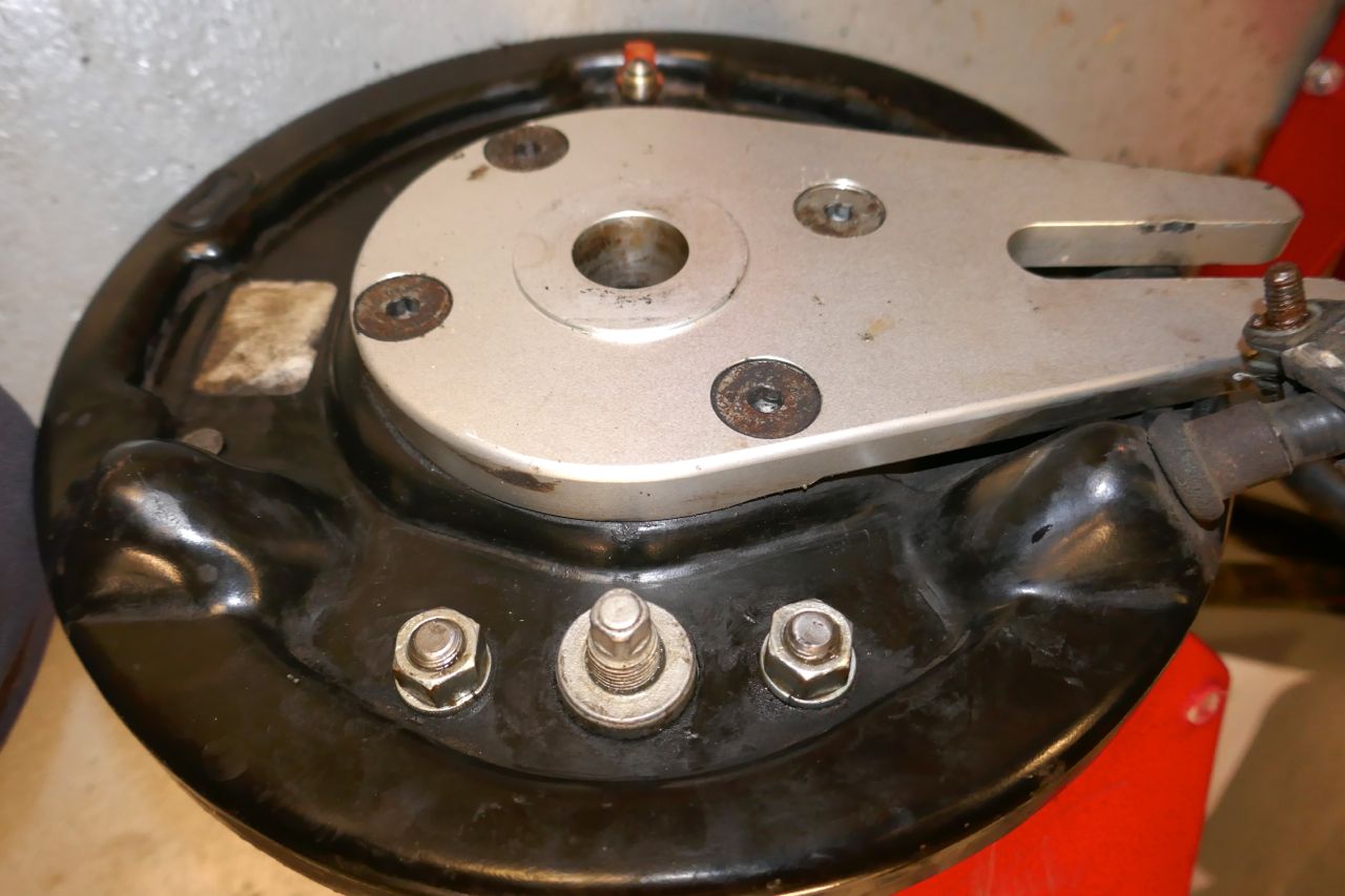

Here it is compared to the standard fixed item.
As you can see it slips right in.
...and all looks very 'stock'.
I set up the adjuster so that the brake shoes are held the same distance apart as the standard fixed item. Just to be clear, I don't intend to use this as a regular adjuster because the standard automatic ratchet device works well most of the time. However, If my pads bind on the drum for some reason then it will now be a doddle to back off the adjuster to allow easy disassembly.
