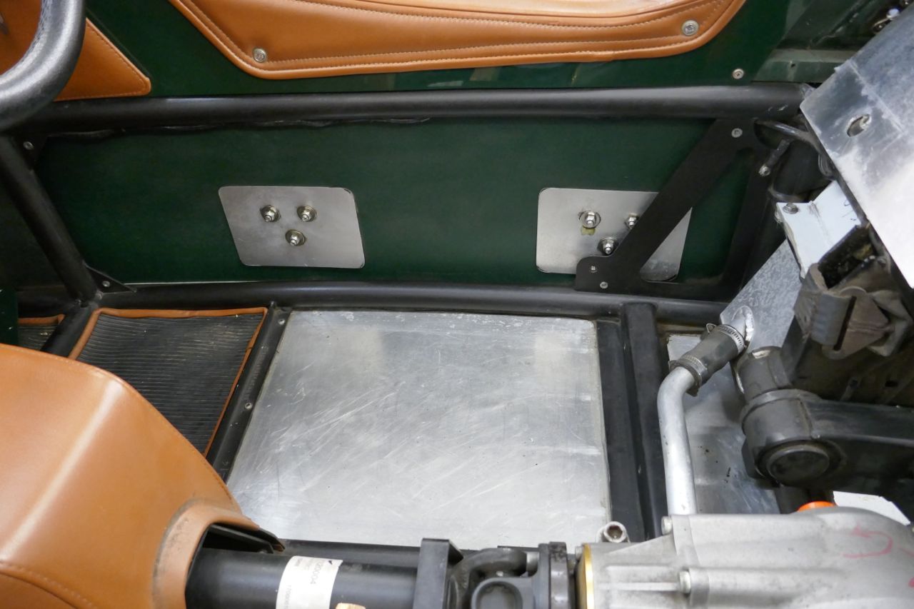

My 2012 car fitted with G56 exhausts had separate (quite small) reinforcing plates behind each exhaust bracket and I had noticed significant 'panel-wobble' when the engine was running.
![[Linked Image]](https://www.tm-img.com/images/2021/06/01/Side-Panel-Reinforcement-1bff8185f2e2ef6d4.jpg)
These plates were 18cm wide and 13cm high.

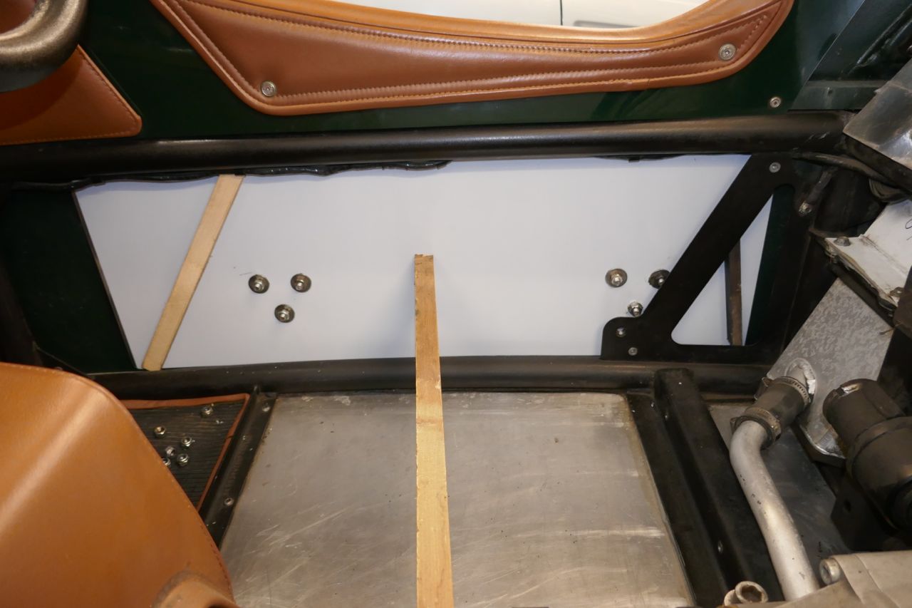

Therefore, one of my lockdown projects was to reinforce the side panels. I used 2mm aluminium, 25cm x 70cm bonded on with PU adhesive.
![[Linked Image]](https://www.tm-img.com/images/2021/06/01/Side-Panel-Reinforcement-1.jpg)
![[Linked Image]](https://www.tm-img.com/images/2021/06/01/Side-Panel-Reinforcement.jpg)
Photo shows temporary wooden batons used to hold it in place while the adhesive cured. I just stuck the new panel over the existing plates.
It has certainly stiffened up the panels no end and the bodywork no longer flexes with the exhaust bracket movement.
