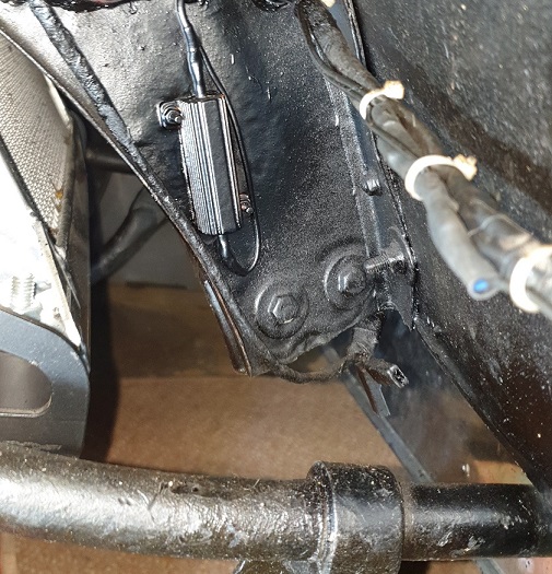

Maybe just worth mentioning…. Should anybody choose to use separate load resistors just be careful how they are mounted. If you can attach them to some substantial metal to dump the heat. They need to dissipate around 20W so whilst not an issue for the normal indicator duty cycle however if the hazards were left on for an extended period they would otherwise get VERY hot.
50W resistor mounted to the inner cowl next to the indicator
