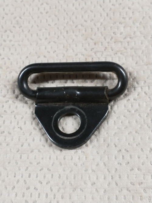

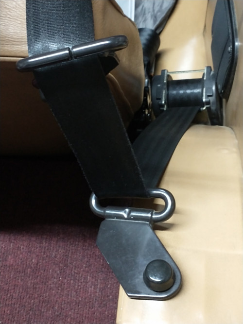

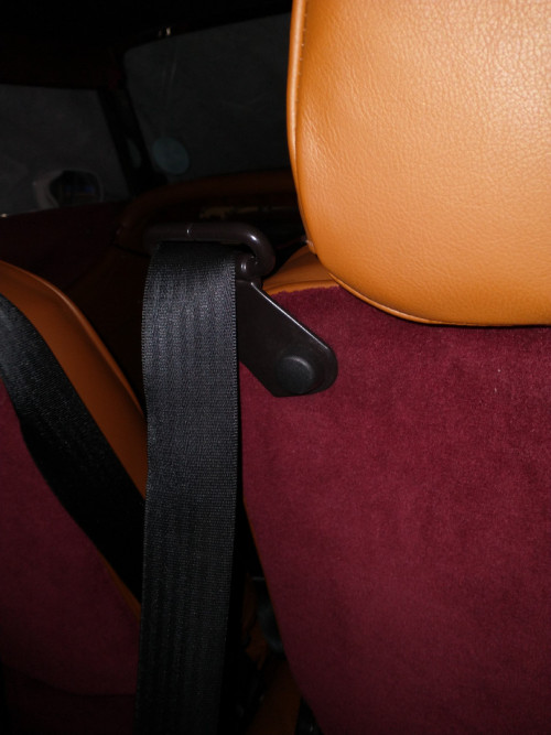

I noticed that the seat belt guide bolted to the top of the rear wheel arch was quite small
compared to the seat belt guide bolted to the back of the seat.
I changed the short guides for a pair of the longer ones. This moves the seat belt further forward and slightly inwards.
I have found, with the hood carefully folded back, there is enough clearance to allow the seat belt free rein.
