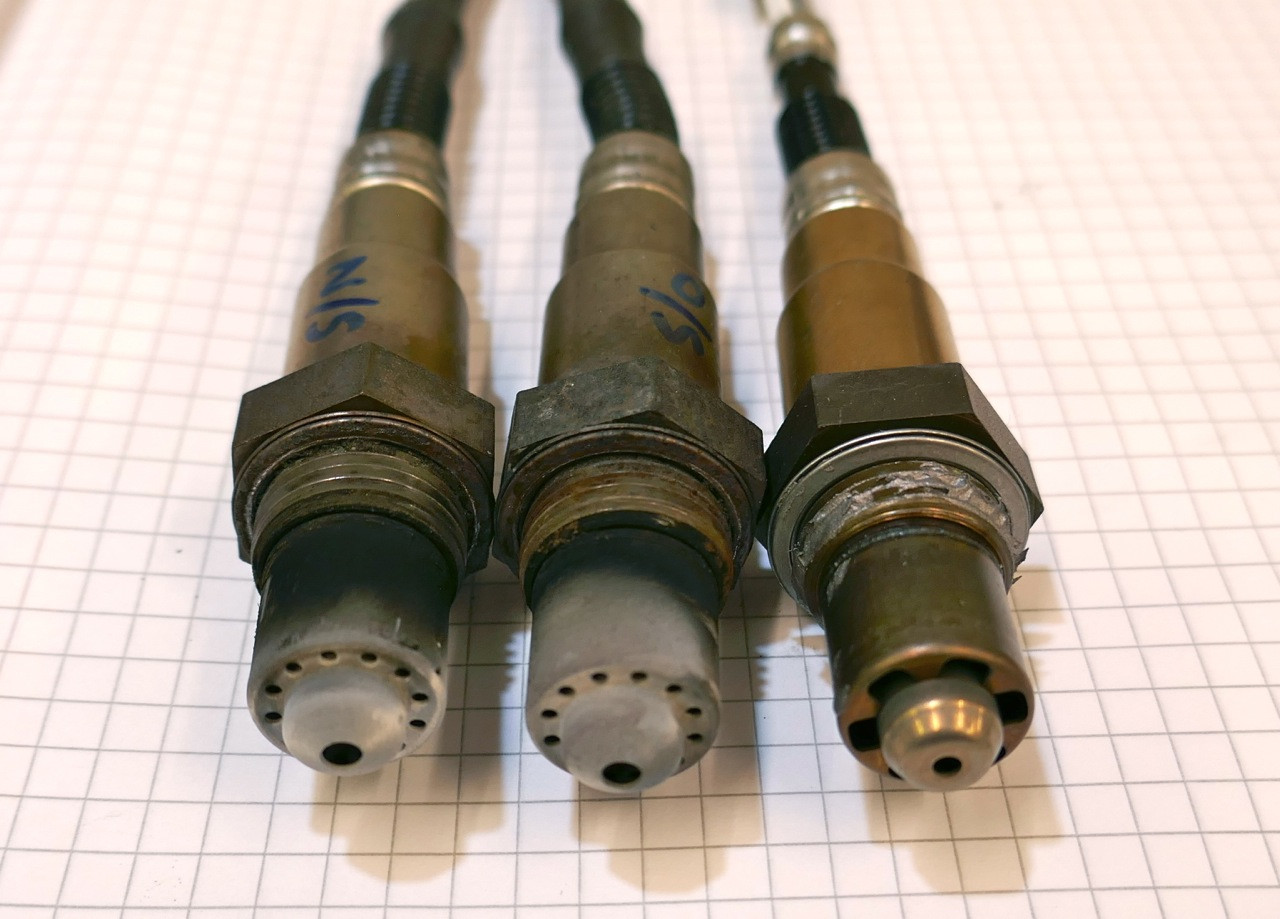

![[Linked Image]](https://www.tm-img.com/images/2022/05/08/Lambda.jpg)
My old sensors on the left and one of the new ones on the right. I can't spot any obvious problem with the old ones but I guess something was on the way out. As R1NGA says, £85 very well spent!
