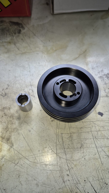

The first stage of my Optimill Quick Release Moto Lita stering wheel project is now complete, the Momo splined insert is currently sized for a medium press fit - 0.03mm interference.
![[Linked Image]](https://i.ibb.co/kVPX2f2D/IMG-20260410-WA0000.jpg)
The machining revealed some very minor porosity in the Momo splined insert, but absolutely no cause for concern.
![[Linked Image]](https://i.ibb.co/7t7pm4JP/IMG-20260410-WA0001.jpg)
Trial fitting to ensure precise aligment prior to pinning is now required, we also need to integrate the automatic indicator switch cancelation system, but we're definitely getting there
