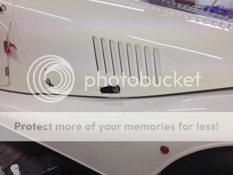

UPDATE TIME FOLKS smile
Oil filter sandwich plate with built in thermostat fitter with -10 aero-quip unions and using pro-lite lines
Aero catches fitted to both sides of the bonnet
Single sheet of aluminium shaped to form the new dash panel
Comments welcome smile
