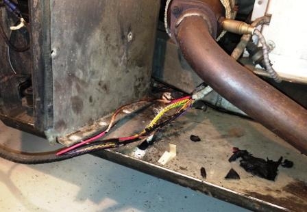

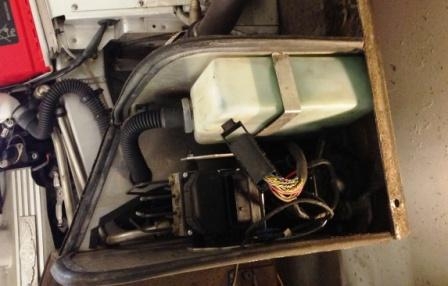

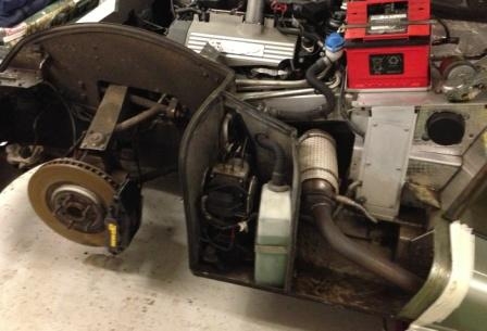

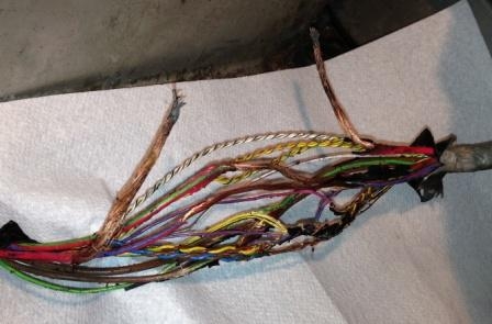

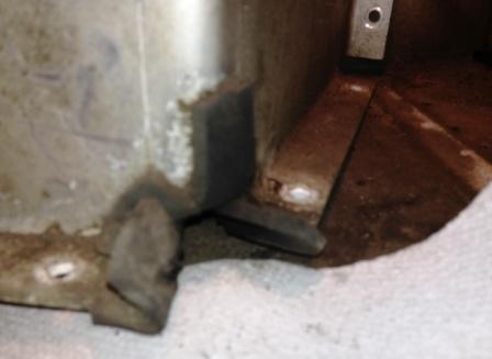

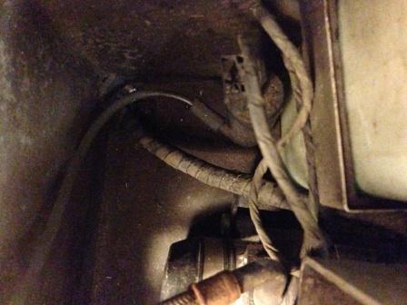

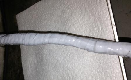

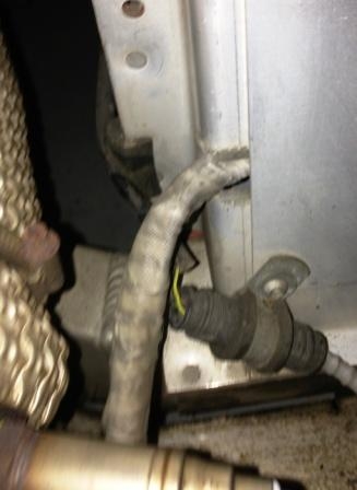

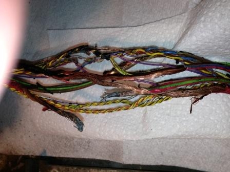

Hi all and many thanks for your suggestions. Following on from my recent post about blowing the 50amp fuse on my Aero 8 MkII in the snow and the subsequent shorting out of the wiring loom. I have attached some photographs as requested of the loom concerned and its location inside the nearside wing. Owners might like to check the point at which the loom passes through the aluminium power steering compartment wall, or at least ask for it to be looked at when the car is next serviced. There are three pieces of rubber around the triangular shaped aperture but my wiring still chaffed and shorted out. New loom is now encased in conduit.

Many thanks for your follow up. The chaffing looks like it was very advanced, obviously just waiting for a wet day to find it out. I am printing your pictures for the file. My car is due a service in May and I will be keen to watch over shoulders to see if there is something similar under my wings.
