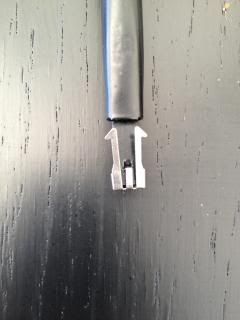

So... After some investigation it seems I understood but not solved) the issue.
The "male" part (2) coming from the "traditional" Morgan has a different milling (?) from the female one (1).
Beside this the housing of (1) is not a snug fit.
It seems that chrome arms (for Aero8) have a tighter fitting.
We will try with those as soon as my dealer get them from the factory.
Meanwhile we did the arm bending and the thing got a little bit better. We did not make the rain-x treatment since we decide to wait for the new arms to better understand the difference.

That is very useful. The fit between 1 & 2 on your schematic is very poor on my Aero - there is a lot of play and I have solved it (temporarily) with gaffer tape. There is still a lot of play in the linkages which means that the 'rest' position of the wipers varies.
The blades I sourced from ebay
28" BLACK Silicone Rubber Wiper Blades Refills 2 Pack £4.95 which you simply cut to fit.
The securing clip will need enlarging
You can just see the irregular filing that I did!
Now 2/3 wipers are perfect and actually clear the screen, one still needs further tweaking.
Good luck

Finally the combination of gaffer tape + twisting a little bit wiper arm it worked.
I do not know if it will work forever but for now it's great.
