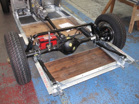

1) Back axle of a 4/4 Sport in production, note the lowering blocks between the spring an axle and Sachs dampers

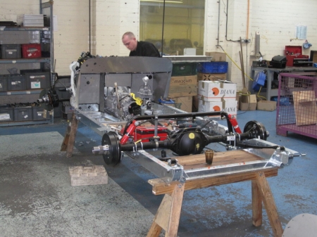

2) Back axle of a new 3.7 Roadster in production, note the Koni dampers (non adjustable) and anti tramp bars fitted

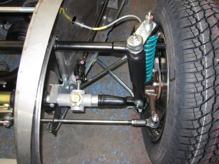

3) Front axle of a 4/4 Sport in production, top view showing Sachs dampers, aeroquip brake hoses, new adjustable camber plates

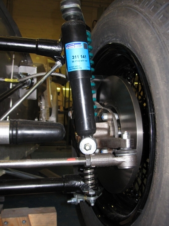

4) Front axle of a 4/4 Sport in production, as above but front view

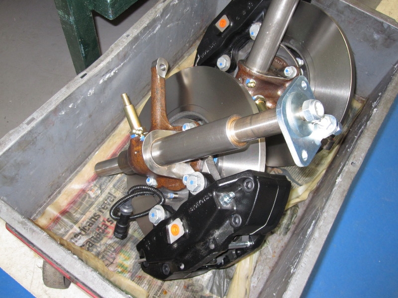

5) Current front king pin sub assembly showing bronze bushes and a clear view of new adjustable camber plates.
Note: the camber plates are only placed here temporarily before transfer to the build shop, they are actually shown on the wrong end of the king pin sub assembly.

Very interesting.When did you take the pictures ?
I wondered if the new 4/4 bespoke had also the lowering block.
Posts: 983
Posts: 983
Hi Thierry,
The photos were all taken in May 2012. I'm not sure if the lowering blocks are on all 4/4s including the bespokes. The car in the photo has 5" stainless steel wires which suggest it may be a bespoke, but only x4 of them (see chassis markings). I asked the chap who was working on the build what it was and he said it was a 4/4 Sport. That's as much as I can add. Others on TM who visit MMC more often may be able to clarify.

I have put a short video in Youtube about the rear axle of my Morgan Roadster 3.7 comparing right hand side with anti-tramp bar to left hand side without it. See how it works during a "normal" drive. I looked also at the torque rod.
URL: http://youtu.be/otP5xU8qvYY (or search for "Morgan Roadster 3.7. rear suspension" or "Winfried Flugsand").

Great stuff! Its amazing that the damper end rubber bushes manage to take up the axle wind up without binding their rods, must be so much worse with no such restraint! PJB

Seems to prove that the 3.7 really needs two anti-tramp bars, one on each side.
Is there a panhard rod?
Posts: 534
Posts: 534
No panhard rod frown

I agree Peter. Strange they only fitted one as surely there would be an imbalance between the two sides?

The reason for me to make this video was the old question 1 or 2 Anti-Tramp bars. After this "normal" drive-video, I wouldn't say a 2nd is really not necessary. But I am not an expert.
