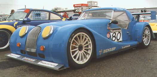

I was thinking about getting a set of white minilites 6 x 15 to look a little like the MMC factory Racer I put in the photo gallery.
Morgan MMC GT2 +8
