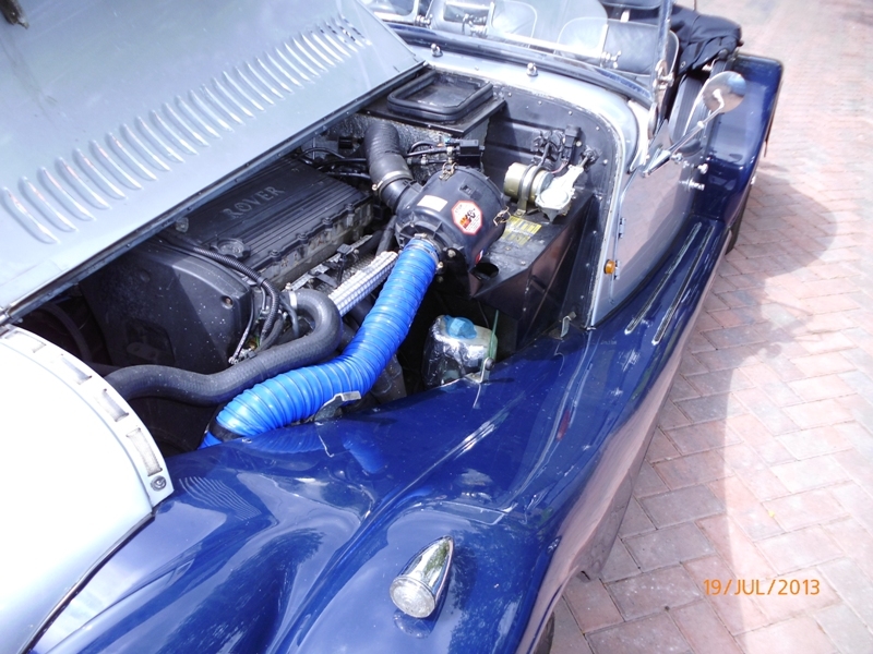

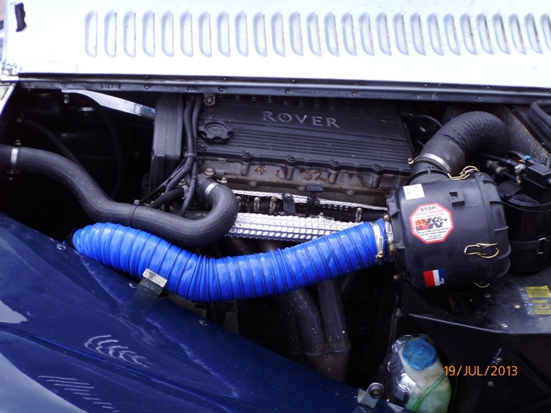

The exhaust having rotted my old hose I replace it with a 1 m length of silicone tubing said to be good for 365 deg c.

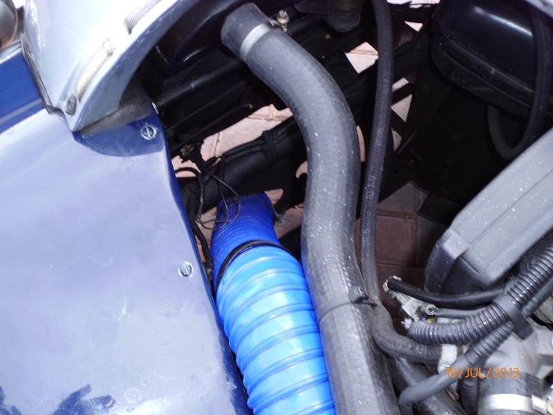

The hole in the original was underneath and I am sure the car was probably sucking in air super heated off the manifold for quite a while.
The longer hose has allowed me to collect air below the rad & it seems to make a difference.

I trust you won't pick up too much road spray in wet weather from under the front of the car. Gerry.

I know I was wondering about that too. Time will tell. I can always cut it back.

My brother in law had a water mist kit on his Ford consul. I dodn't think it will be bad news in spray but a flood might be so I might move it or cut it back.
