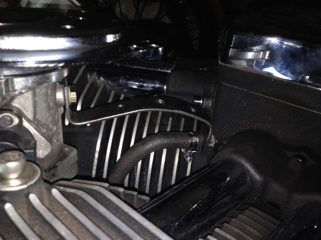

today i clean my air filter and i see that all the air filter is moving up and dawn about 1 cm and a connector is in contact with the right cylinder.
i make a support
Posts: 2,360
Posts: 2,360
warning
i found the problem
it was put without two fixation on the engine

Hi Atlanta
Did you make those brackets you show in your last picture or were they in withering the adaptor kit?

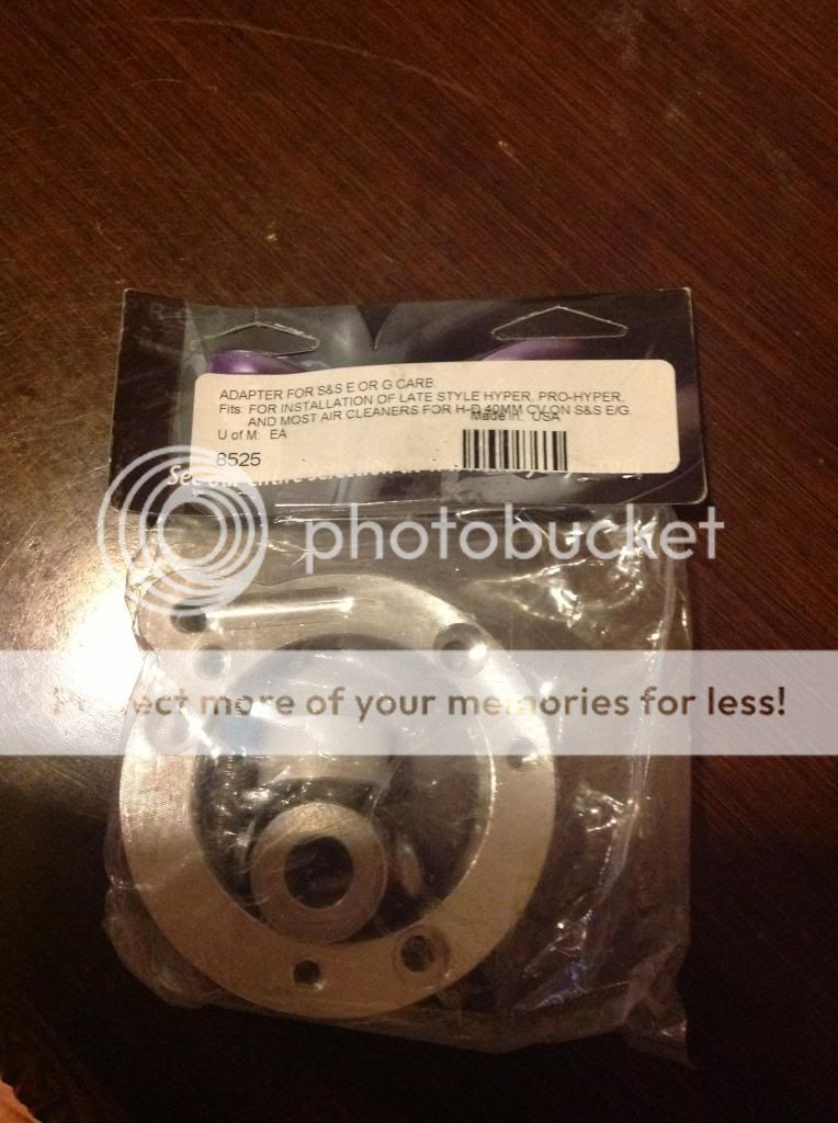

-I installed my filter with the adaptor only.
-I didn't use the factory back plate that was on the factory filter.
-The adaptor kit doesn't come with brackets

I do brackets
The air filter must be hold on the cylinders as it is with the original one from morgan.
Mine was moving when i touch it, all the pipe was translating about 1cm
Now it doesn ´t move at all
