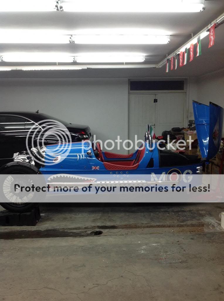

1st lifting the m3w
[url=[URL=http://s1349.photobucket.com/user/Q8morgan/media/image_zps0ccd49d0.jpg.html][/url]][/url]

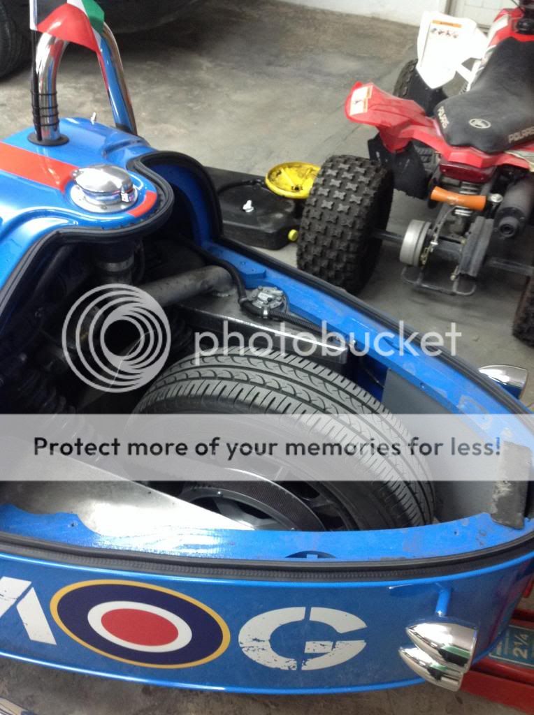

2nd openning the rear bonnet
[url=[URL=http://s1349.photobucket.com/user/Q8morgan/media/image_zps5f4a720d.jpg.html][/url]][/url]

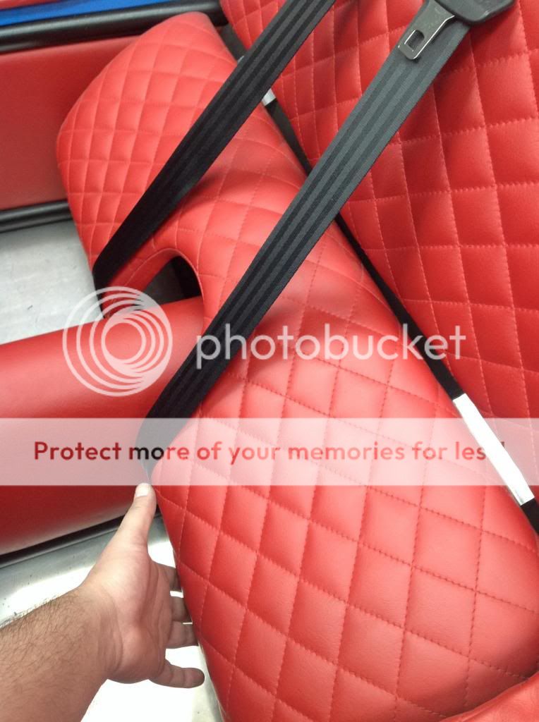

Remove the botton seat cushions
[url=[URL=http://s1349.photobucket.com/user/Q8morgan/media/image_zps3fc9e1f7.jpg.html][/url]][/url]

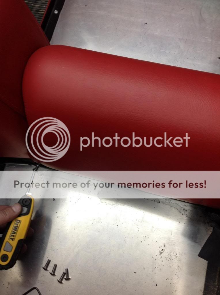

Remove 2 size 10 bolts on each side to remove the seats
[url=[URL=http://s1349.photobucket.com/user/Q8morgan/media/image_zps9137eec9.jpg.html][/url]][/url]

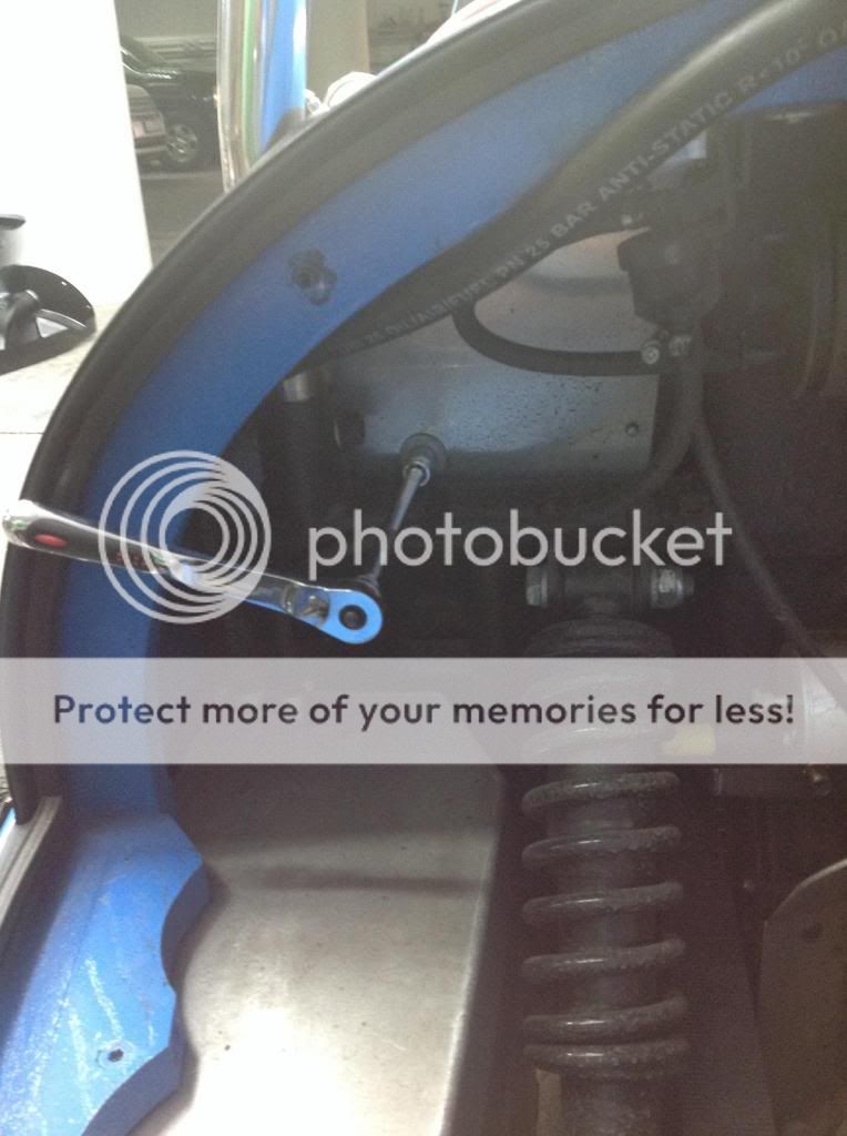

Remove the 8 bolts on the drive shaft cover,the lower 4 are a different size
[url=[URL=http://s1349.photobucket.com/user/Q8morgan/media/image_zpsaeebe2fb.jpg.html][/url]][/url]
