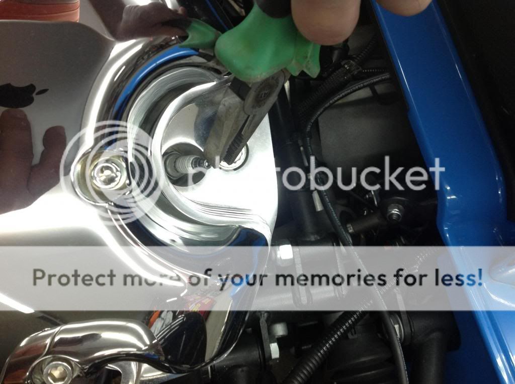

My left spark plug cap comes off every once and a while. Makes for a pretty spectacular noise. Havenīt figured out how to tighten without damaging the rubber - how do you do it?

Sorry i meant the caps on the spark plug itself,but if the factory wire caps come off,look inside them,try to tighten the metal inside that clicks on the spark plug,gentle use pliers on them
[url=[URL=http://s1349.photobucket.com/user/Q8morgan/media/image_zpsc479a572.jpg.html][/url]][/url]
