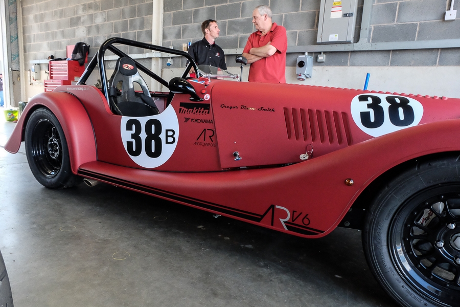

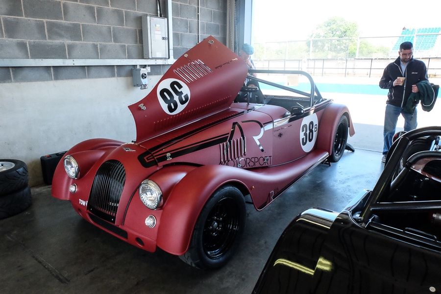

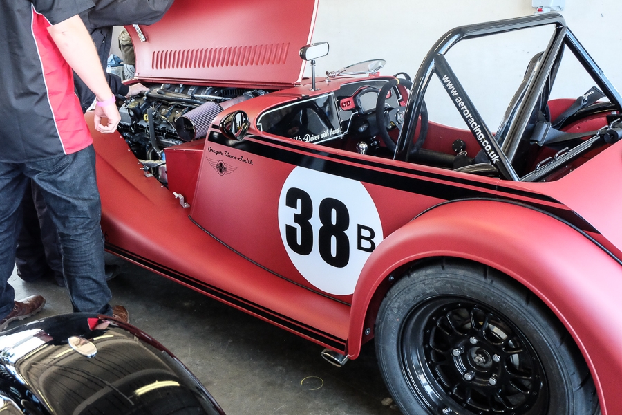

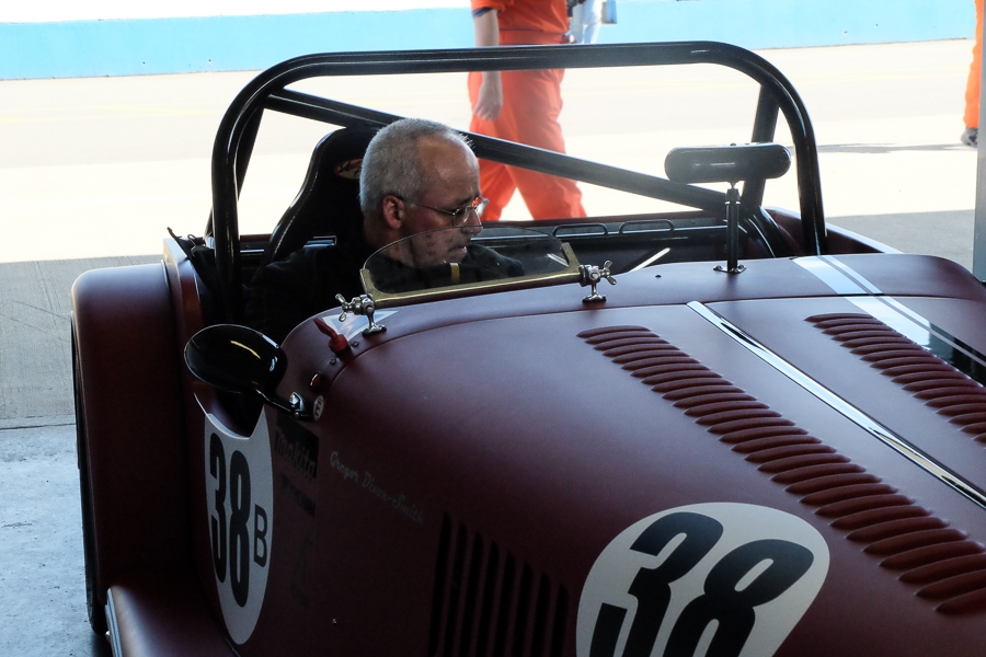

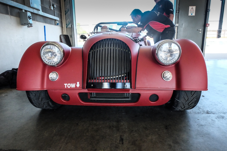

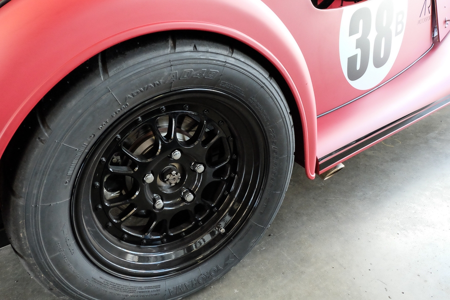

The new ARV6 at Donnington
Don't get too excited.....no photos of the car racing, I'd not packed my Canon! But these photos of the car in the pits should give an idea of the main features.
I think that I recognised Guenter lurking in the pits with a brace of Canons taking photos so hopefully he got access trackside and got some good shots to his usual high standard.

Could you please tell me if the headlights are "plug and play" or do you have to cut in to the wiring ?

The headlamp is plug and play but the side light needs a bit of cut and join as the LED bit has a pair of bare wires so you have to cut the wire to the sidelight connector.
I used proper connectors so I could always re-fit the old headlamp.
