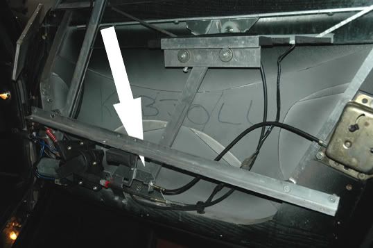

Due to a broken doorhandle cable, I had to disassemble the Aero's door. Now I know how to dismantle the doors, I'm gonna try to fix my door top aligment.

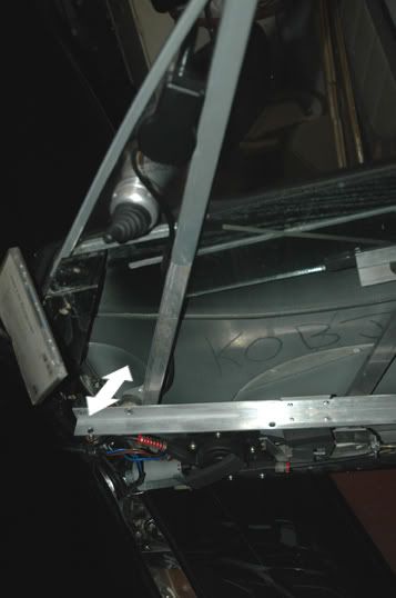

I've made some pictures, because I've noticed there are no screws in the middle bottom strut. Is this normal or a part of the problem?
Here are the holes, no screw to be seen.
Or should I get some extra rubber between this brace so the top would move more inward?

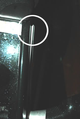

Take a look at the misalignment on the driver side and you'll see why I'm so eager to fix it. Lots of windnoise!
So if any of you guys can give me some advice (Cerealsurfer?), shoot! oldgit Thanks! cheers

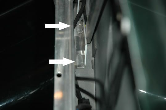

Alignment is way out of true isn't it! From the photos the screw holes do not appear to marry up with other holes? In 2nd photo is that a slim piece of foam on the doorskin? if so is this to stop vibration overall or is it a buffer that the vertical strut should be positioned against? Moving the strut against this foam would pivot the top inwards.
Has Yuri had any experience (he removed the door handles) or did the alcohol kill off the relevant memory cells?
In the last photo there appears to be a "corner" added to your hood material - what's that about? thinking
Best of luck with the reconstruction
The strut is loose, I can wiggle it so it does match the holes. Weird. confused2
Very good observation! Just went to the garage for a quick look, it's a small piece of foam, I guess it should touch the strut. Otherwise it would have no use there.
I have two of those! Each corner is strengthened with a patch of leather. I thought this was standard?
