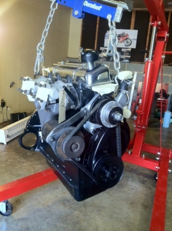

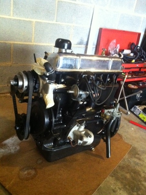

Rebuilt EngineRe
Leak tested head, reground valves, ground camshaft, hardened valve seats, 87mm piston liners, reconditioned con rods, ground crank, rear crank seal conversion, balanced rotating assembly, new timing chain and tensioner, new hi torque starter, rebuilt dizzy, rebuilt oil pump, all new gaskets and seals, and all cleaned up
