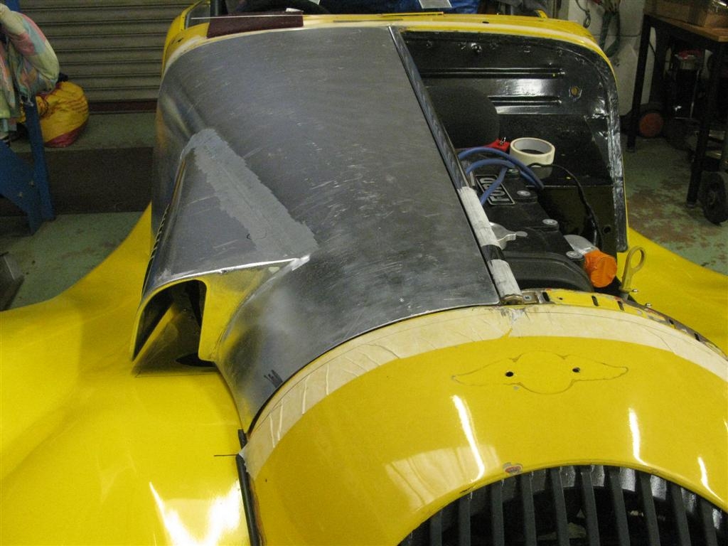

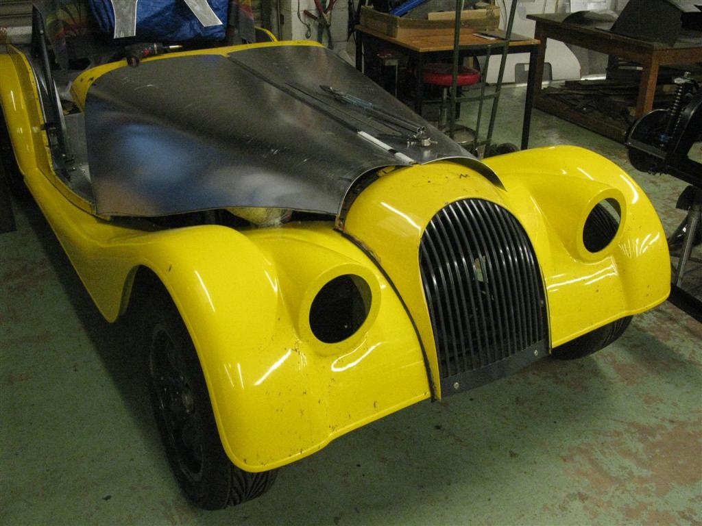

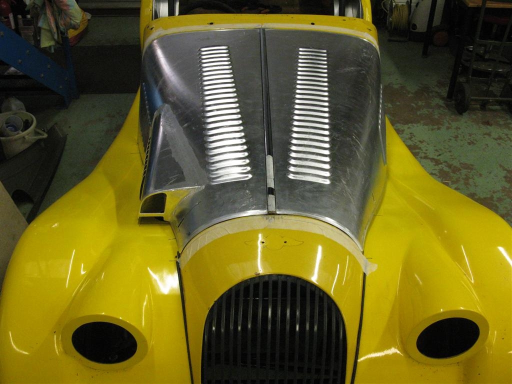

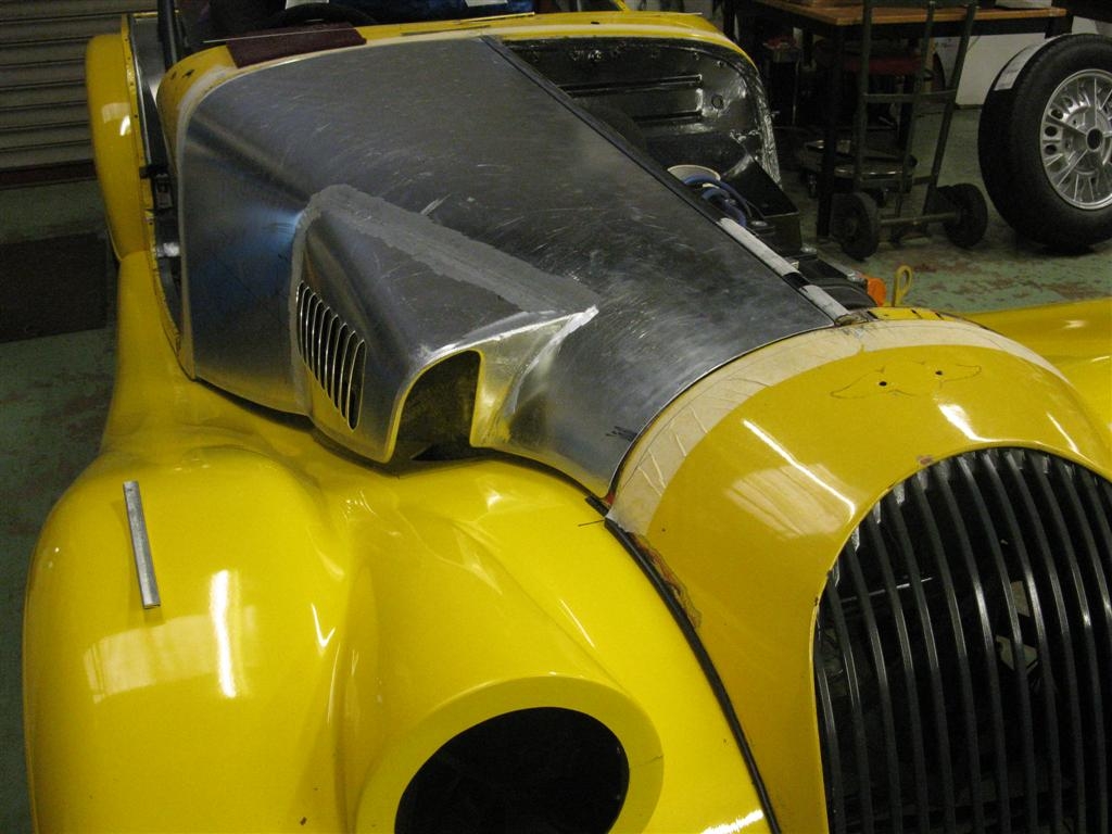

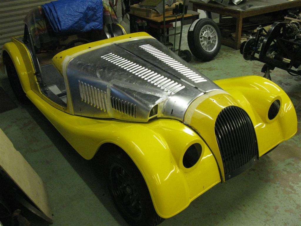

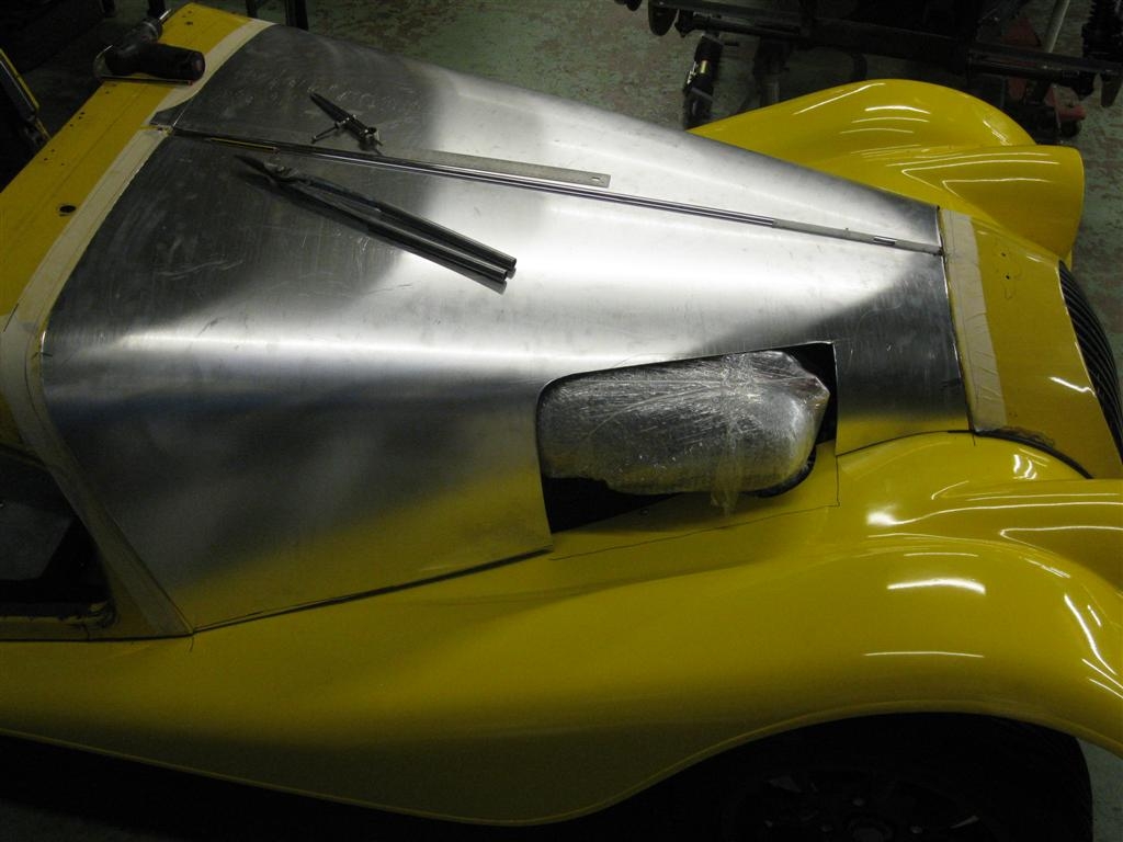

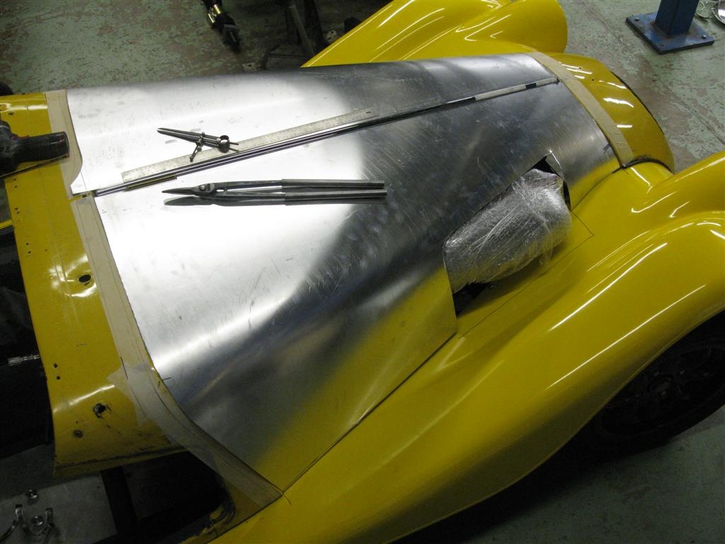

Now the front wings are on we shipped Woodstock up to Vintage Sheet Metal to have the bonnets made - same brief as the Blue and White race car - lots of louvres - the new larger ones.
You can see in the sequence below the stages that are gone through to make a custom fit bonnet - fantastic stuff.
Creating the basic shape
Creating the hole for the SS scoop
Attaching the SS scoop blank
Starting the louvres
extending the louvres along the bonnets
The finished product with the central hinge in place and the clip bracket holes cut into place.

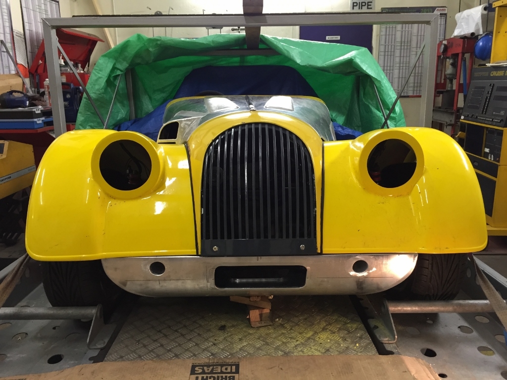

VSM also came up with a front under tray for the front of Woodstock
I'm currently working with Cain on possible concepts for a replacement for the racing +8 front splitters - we've yet to see where this may go but quite an exciting development - we'll keep you posted on how this comes along.
