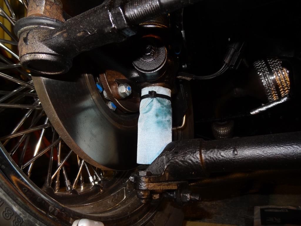

I can see a lot of sense in comments about gaiters on the lower springs of the front suspension (not sure about the tops ones) – so fitted a home-made gaiter made from tough woven polyester shower screen/blind material and a couple of bits of Velcro. Velcro stuck and sewn on with a half a plastic plant label behind the hoop Velcro to provide some stiffening.
The shower screen/blind material is thin enough to sit around the whole spring right down to the king pin mounting ring and all held in place with a cable tie. Time will tell if this is robust enough.
