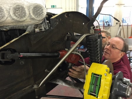

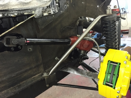

Looks like you slotted the chassis end of the brake reaction bar? Is this just a photo illusion or??? Speed of strip down at the track?
Sorry to disappoint - it's a crumb of dirt.... This is not a part I would consider slotting in that way given the flex induced whilst on track!!

That was my thinking ;-) especially as most load is tensile under braking on the bars. You must put quite some load on there!

Without a full ROPS cage which is braced to both front and rear suspension tops (ie. Cross head king pin top mount) enough twist is induced into he chassis to get the rear of the bonnet to ride up 10mm back on the bulkhead.
