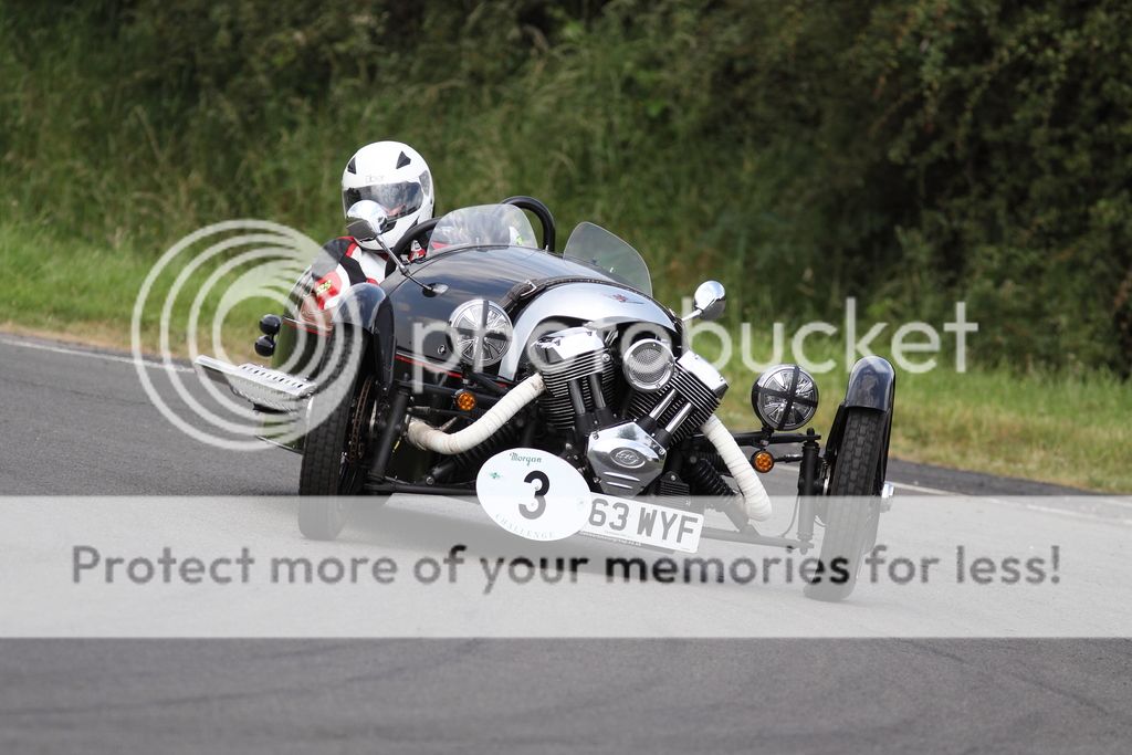

Wow that has deformed. I assume it isi a tubed tyre as the wall bead seems to be off the wheel rim.
