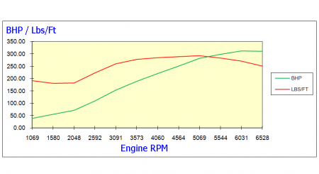

V8 Power Curves
Here's an image of the dyno BHP and torque curves for my engine.

Rover V8 or BMW V8??
Joined: Apr 2009
Posts: 1,036
C
C
Joined: Apr 2009
Posts: 1,036
Rover V8, 1950s Yankee technology, single cam, overhead valves and no ECU!

THAT right there is sweet..!! thumbs

Too right!! thumbs
Glad to see it all coming together David.

Wow thats impressive.
If I would have seen that last year I would have considered a Plus8 instead of my roadster. What displacement does the engine have? What modications did it require to get to this level?
Hi Beltempo,
It's a 3.9 litre, 94mm bore interim cross-bolted serpentine block with Omega forged pistons, balanced crankshaft and rods, lightened flywheel, competition clutch with a Piper 234 hydraulic camshaft, medium size valved cylinder heads, quad downdraft Dellorto 45s, large bore exhaust primaries and a high-capacity anti-surge sump.
The rest of the car is rather modified.

Great performance. Do the Dellorto have a fuel pump to squirt in extra fuel if you floor it like I had on my Motto Guzzi Le Mans?

Hi John, they do have in-built pumps.
