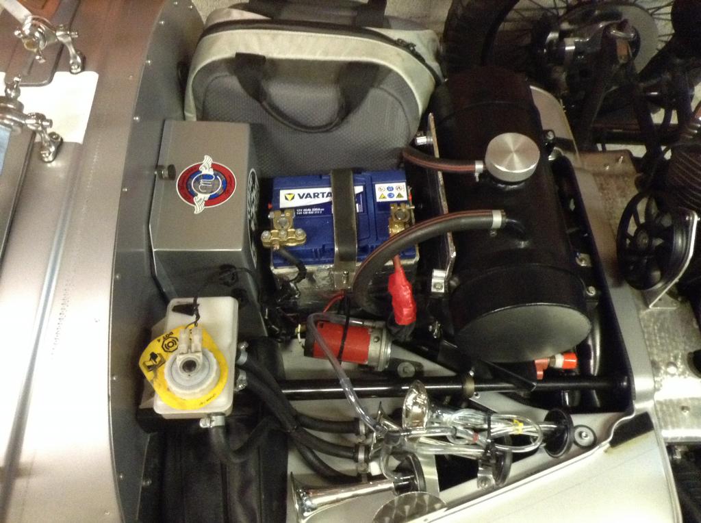

I dismantle the starter
The selunoid run but not the starter
My centa unit is new...
Posts: 2,356
Posts: 2,356
New Varta

So are all your starter problems gone after fitting a new battery? What is the part number please. Is it a straight swap with no modifications required to fit?
