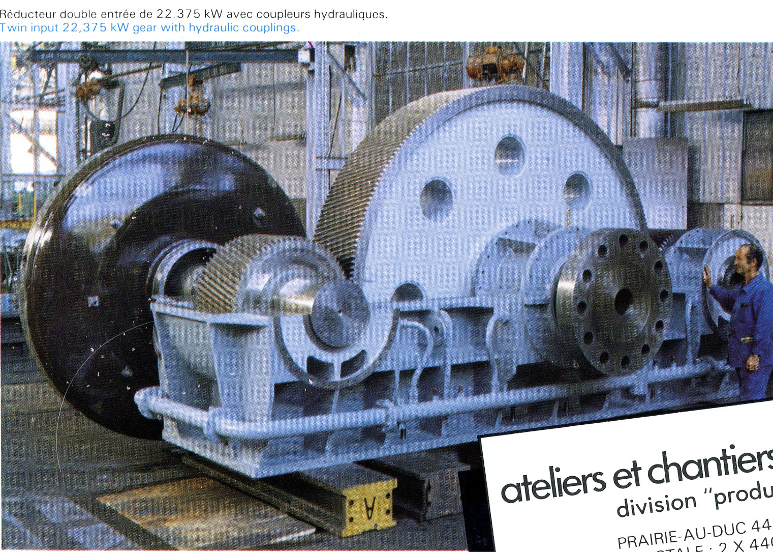

In the first company where I worked in 70-80, we made gears for ships, with more than 2.5m diameter wheel. For noise analysis we used Brüel & Kjaer analyser.
