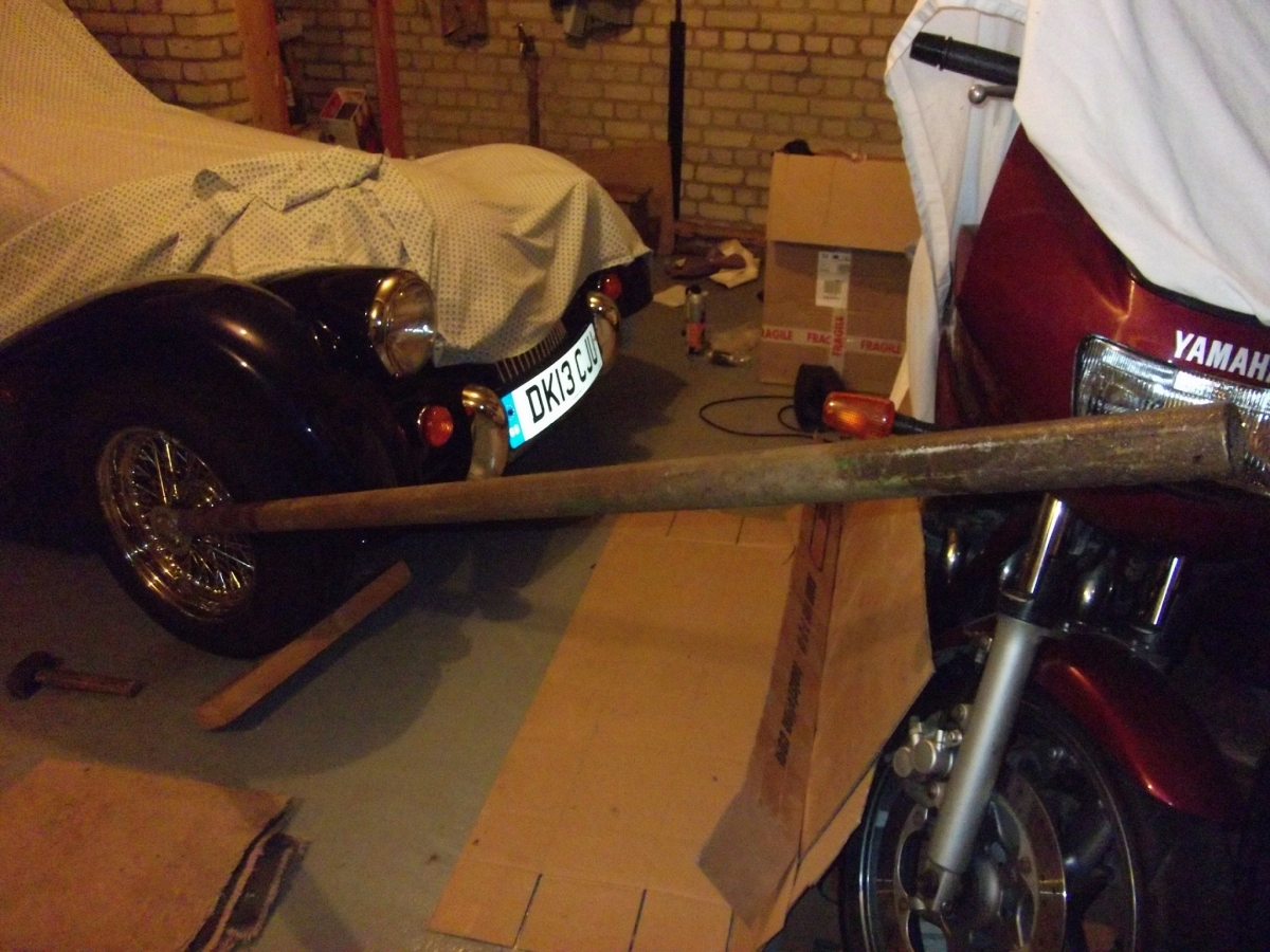

Tight Nut or what.
The 1.8m scaffolding tube simply turns the wheel on the garage floor. I'll back the car out onto the tarmac drive tomorrow to try and get a bit more friction. It loosened the other 3 factory fitted wheels but this one was refitted by our dealer in Northwich. It may have been the body builder with the 3m bar.
ps. I am turning it clockwise before anyone asks.

Get someone to put their foot on the brake. The will help with grip.
If the wheel still lifts, try from the other side.

I had a similar problem and found that the only way to loosen it at all was to use the hammer and shock it. It eventually moved a smidgeon and then I went back to the bar. I have no idea why they are done up so tight.

Mild application of heat from a blowlamp will loosen it.

I found this with tight spinners - the hammer seemed to shock it, exactly as you describe.

A bit of 4x2 on the brake pedal if no help available!

Those guns for stripping paint used on a low setting are really effective for this.
