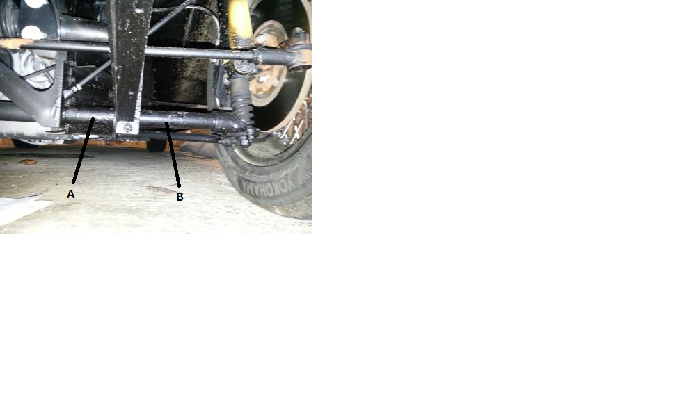

Christmas Quiz - A or B?
Sorry to put this in here instead of the maintenance section but I couldn't find a way to put a photo in an ordinary post.
Can anyone help - A or B for the axle stands (one each side obviously)?

B is better for stability but the tube is strong.
Thanks. I've just knocked up a load-spreader for the jack as well!

I would say it depends on what you want to do. When greasing the suspension I tend to have the stands slightly inboard so as to have more space.
If I am cleaning the flies etc out of the rad or just having a general look around then outboard.
If you look at Dave W brilliant posts, you will see how to make a wooden device to spread the load when using a trolley jack.

As a new Morgan owner, jacking points are a concern to me and therefore this photo is very helpful. Would a positional marker at point B with gaffer tape or something better help to 'feel' for access in difficult situations. Also, Is this a good point for the standard supplied jack.
Does anyone have a similar positional jacking point photo for the rear?

I normally use B

If you are stuck "out and about" and have to use the spare, before jacking up (or after just starting) place the spare under the car and then switch with the flat asap just in case. Should all fail it will limit the impact.
I use B as well but didn't think about it too deeply
I think I first asked the question on how to jack up the Mog at the chaps from Lifes Motors, I don't remember whether they were too specific on the position on the front cross member but I do remember Matty telling me to make sure the jacks are under the chassis cross member on the back and not under the wooden floor
