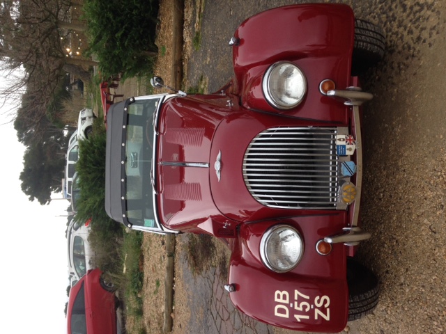

I must say I do like my alloys on the Roadster
