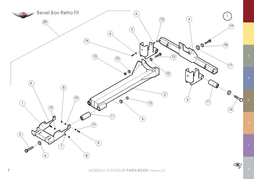

Its secured at the rear as well.
At some point in production a different mount was employed seemingly to spread the torque reaction load from the box's rear mounting points. This retro-fit kit illustrates the metalastic bushes (11) isolating the box from the chassis.
