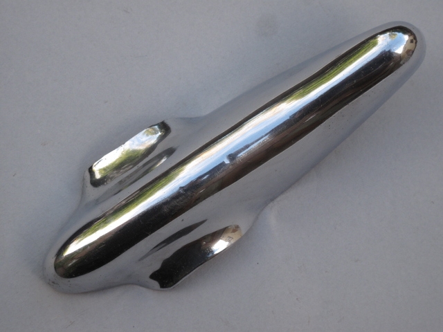

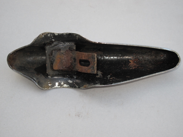

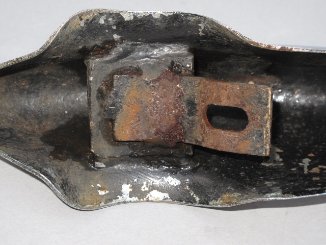

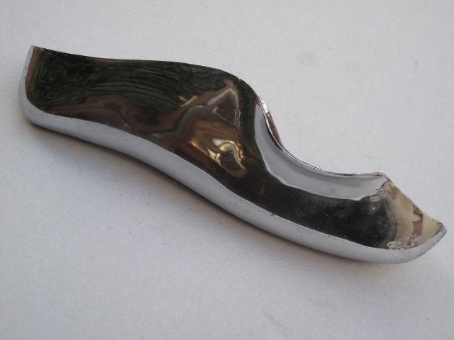

These images show the modification to the Morris Minor overriders for fitment to a Morgan.
Essentially, standard mounting whole is closed and repositioned with an 1/8" steel welded bracket. There is a bend and a further slight curved bend that allows the overriders to be balanced for height as well as alignment on a vertical axis.
The overriders are bolted to the existing bumper irons with a 1/2" thick spacer.
