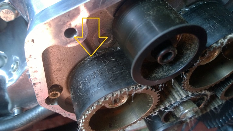

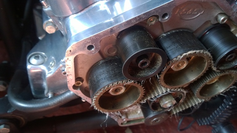

Shocking, this one had been changed only a few thousand miles ago. Guess I am going to need a new one. Promptly.  What is all the hairy "tobbaco" dust in there, degredation of the belt itself I presume?  I havent changed it before, is it a fairly simple job?

This should help
http://www.talkmorgan.com/ubbthreads.php/ubb/showflat/Number/229212/Searchpage/3/Main/17438/Words/cambelt/Search/true/Re:_Cam_Belt#Post229212

This should help
http://www.talkmorgan.com/ubbthreads.php/ubb/showflat/Number/229212/Searchpage/3/Main/17438/Words/cambelt/Search/true/Re:_Cam_Belt#Post229212 I have replaced mine it took about 40 mins. The instructions above will work but you do not need to remove the crankshaft bolt and washer, only the idler pulleys. To keep the tension off the tensioner I used a piece of rope tied to the spanner and then to the indicator support, this keeps the tension off and you can then fit the belt.

Justin-time that is just in time you found out !
Do you have the washers between your belt cover to get the temperature down ?
