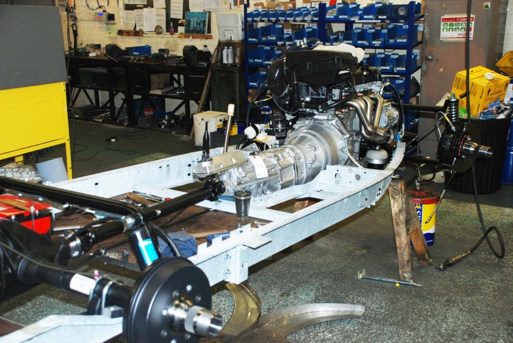

WoW WoW, long long time i haven't see such approximative piece (in some R8 Gordini we have similar **** job)
based on the vid & pic's you will need more than just Teflon spacer you also need a tiny tube around the screw , and also a cylinder around the lower tube.
If you need i made you a sketch for understand better my FranGlish let me know

If I understand correctly what I am looking at it is actually a remote linkage. Most likely the concept is similar to the remote linkage that sits on top of the Mazda box in the 4 cylinder cars. There is a big difference in the remote built by Vitesse that you can see in the picture below.
The difference is that the Vitesse unit is in an enclosed case, bathed in oil, and uses nylon bushes. All in all tight and well engineered.

I did wonder why the pivot point was resting on the threads the bolts shoulder isn't long enough I will source one with a better fit and function the forked part is sleeved each side but the centre pivot hole isn't almost like an m6 in an m8 hole but probably imperial equivalent.
I may have to consult the drawings from factory to see what should be fitted!

It was your woes that prompted me to look at mine Peter.
The vitesse unit looks like a much better solution.
This may be a Ford part in totality as the bush at the back has a Ford stamp in it.
