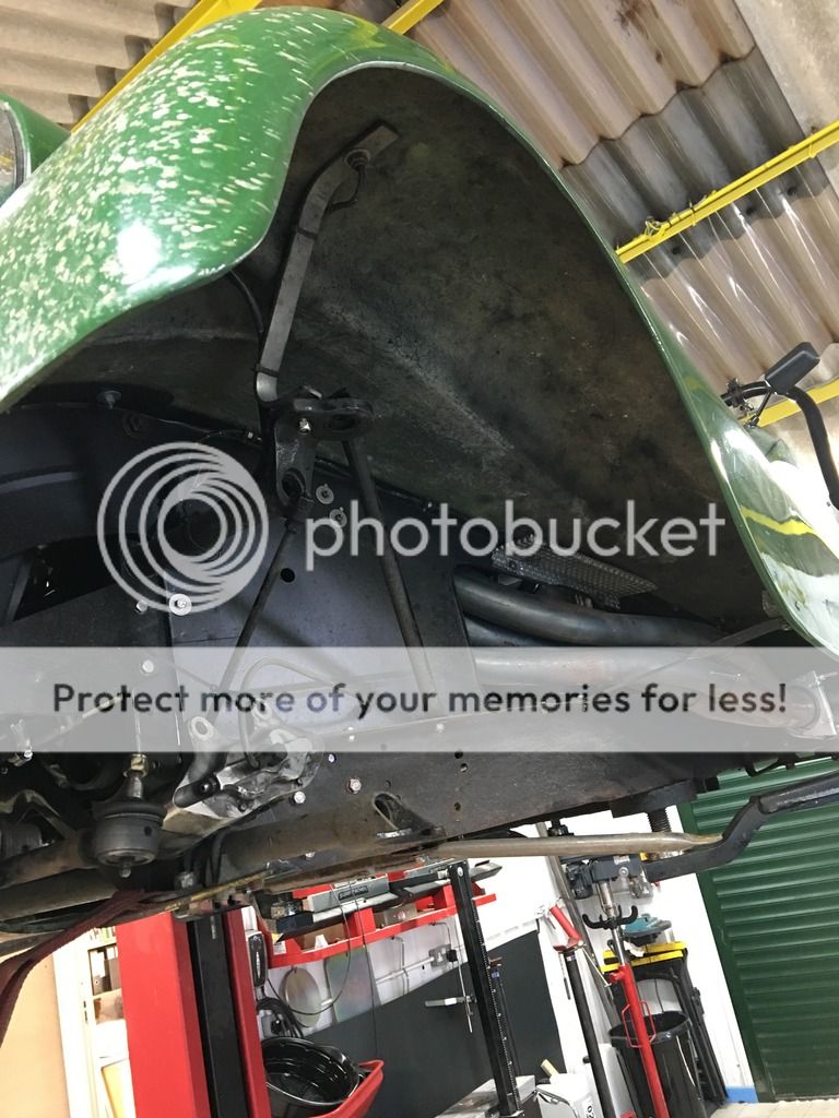

Once the suspension was fitted, the ride height was then set
Thats how the car raced with set up constantly being adjusted to suit Johns driving.

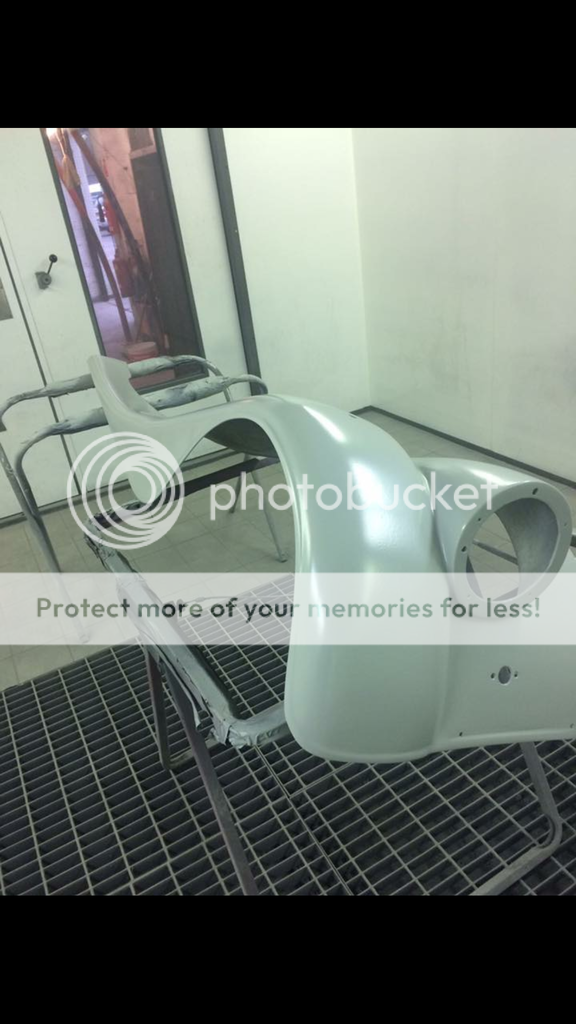

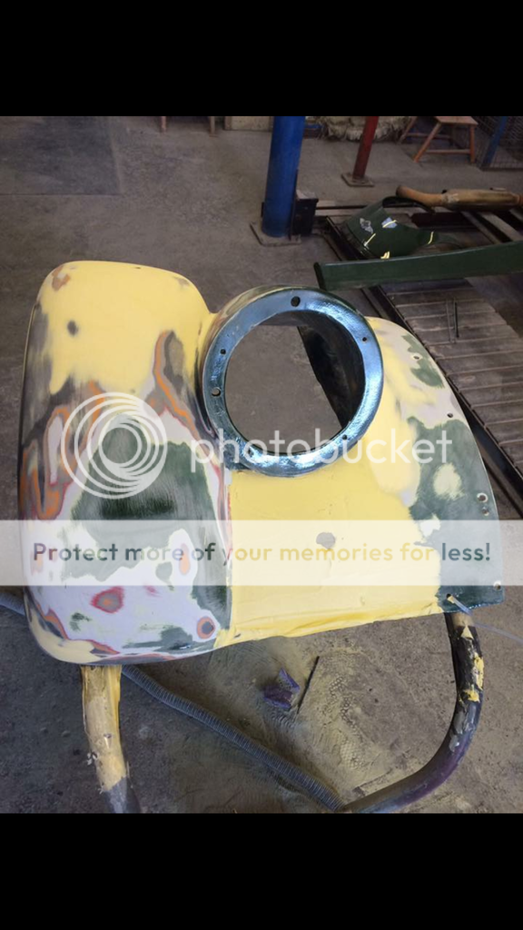

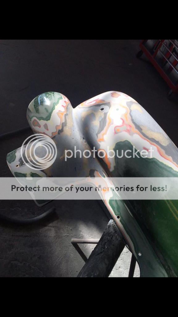

I then sent the car to the bodyshop to have the OS wing and both inner wings repaired.
Once the car came back the build went up a gear.

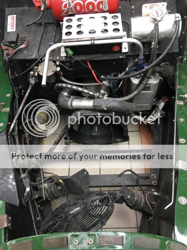

The engine bay was fully cleaned

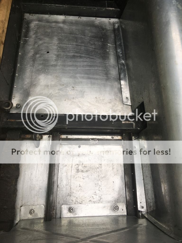

The cabin are was cleaned due being covering in engine oil.

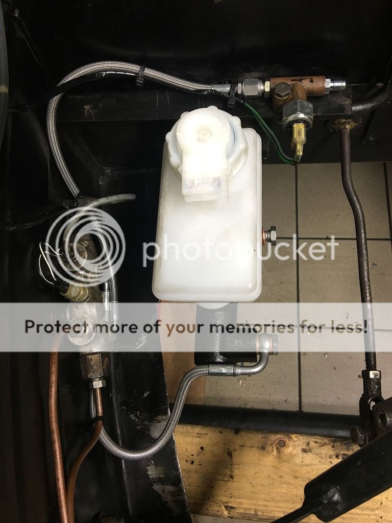

John had always had an issue with spongy brakes, I decided to remove the brake master cylinder for a full inspection. I found that corrosion had set into the seals and se a new item along with new braided lines was installed.

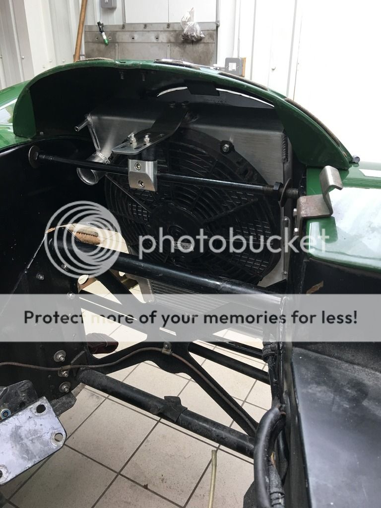

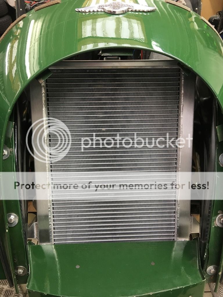

The next aera to then sort out was making sure our Williams comp spec radiator fitted along with a nice 13 row oil cooler

Now the complete fuel system is in the process of being fully updated, so out with the old
Al parts have now been ordered.
