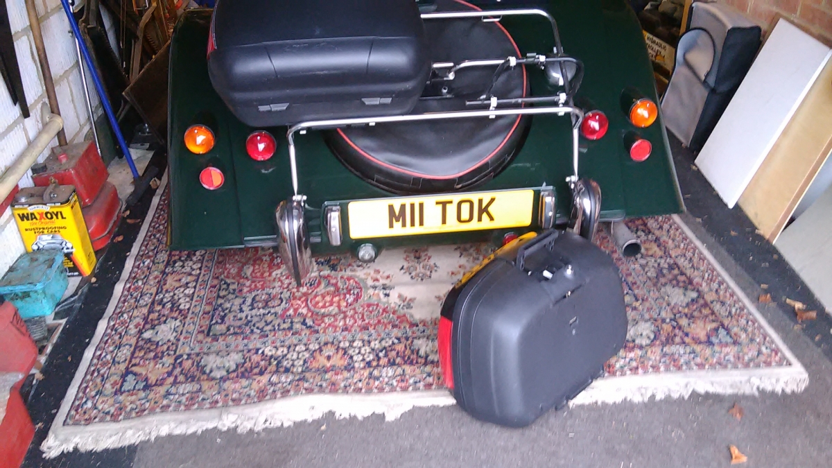

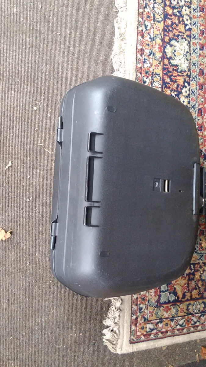

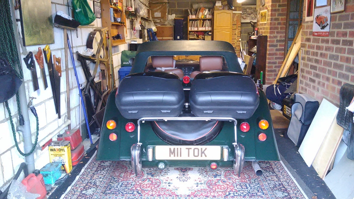

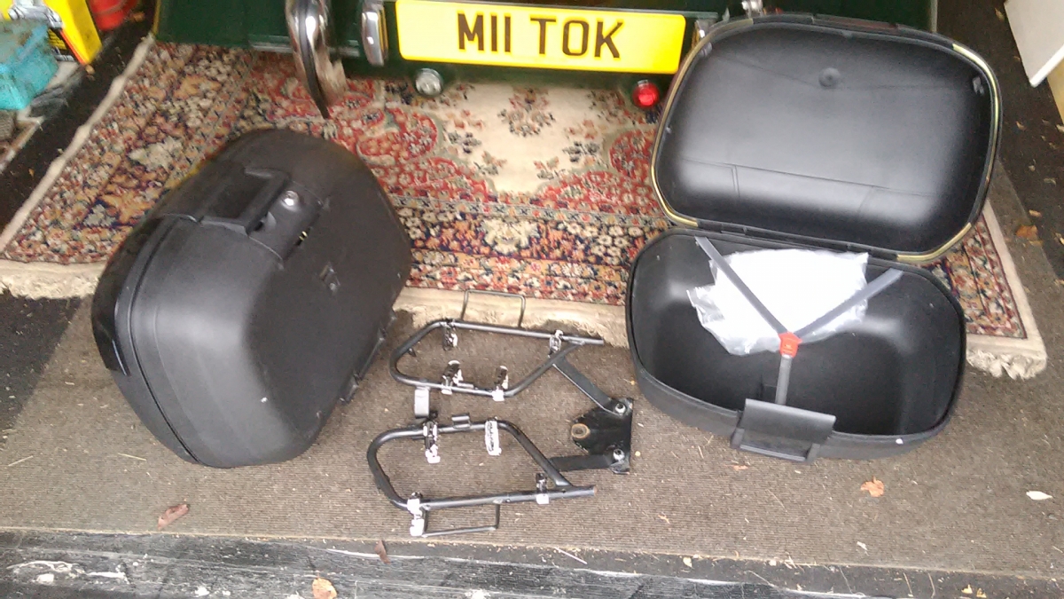

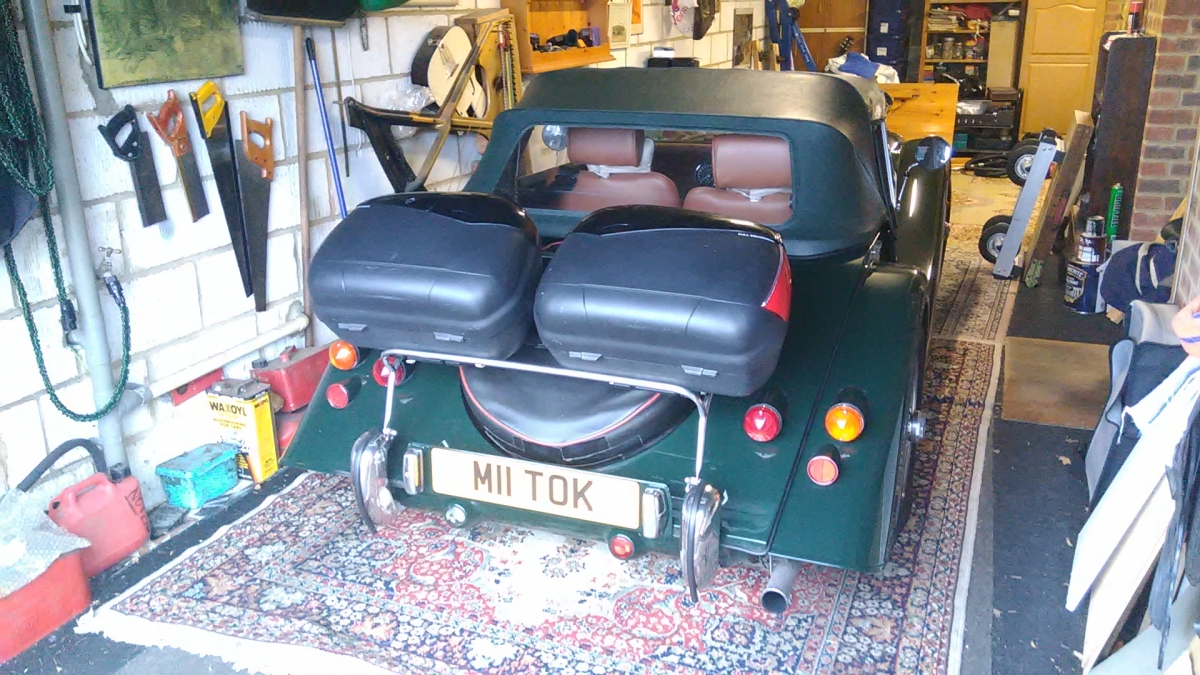

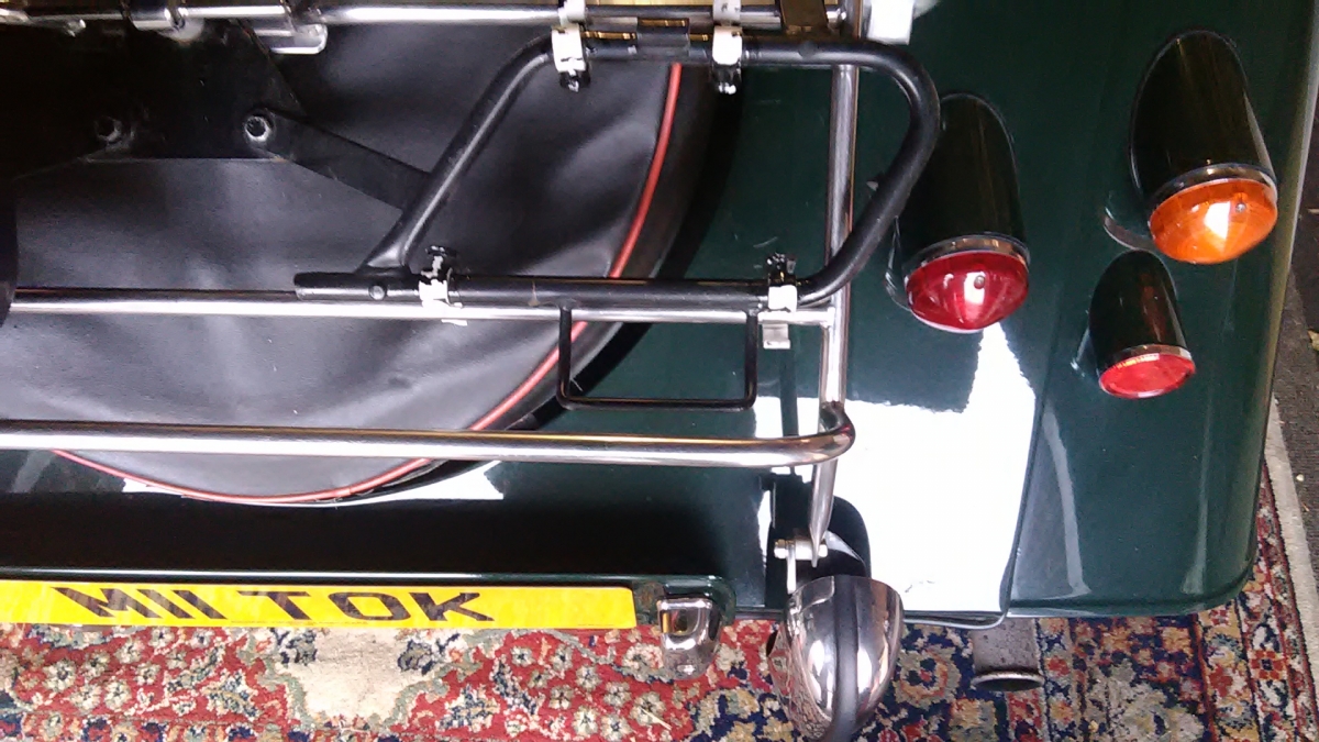

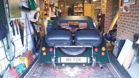

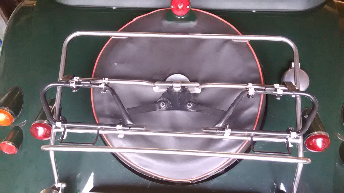

I promised to post some pics of my luggage solution so here they are.
The first shows the frame folded. Next fitted and the cases clip on and lock so no straps needed. The high brake light shows through. The cases hold a massive amount and can be carried into a hotel. Basically it's a set of bike panniers with the framework adapted. I had to make the triangular plate that fits to the luggage rack. The (white where the black paint has worn off) clips are plumbers water pipe clips which rotate merrily to fit. It all takes about 3 minutes to fit and is totally secure.

Very neat Nick!
The panniers do look like Givi type. A make well respected in the two wheeled touring fraternity.

I neat idea.

Very similar to my approach in 2015
http://www.talkmorgan.com/ubbthreads.php/topics/318793/An_Alternative_Luggage_Solutio#Post318793
I am considering making up a pair of pannier frames to fit to the existing carrier so that I can use a couple of the GIVI soft bags for extra luggage capacity.

Ingenious Nick
Better than one large heavy suitcase that does your back in lifting it on and off
You could write 'His' and 'Hers' on the cases
